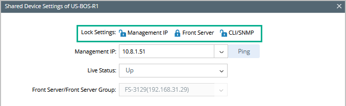

  1. Right-click the device on a map page and select Shared Device Settings from the drop-down menu. The following dialog is opened.
Information Tip: You can open the Shared Device Settings window in two ways: either by using Data Accuracy Resolution or Tune Live Access features. Just right-click on the device name to access it.
Tip: You can lock Management IP, Front Server, and the CLI/SNMP setting if you don’t want other tasks to change your settings.
  1. To change Management IP or Front Server, select an item from the corresponding list and click Ping. The system will use the Front Server to ping the corresponding interface and automatically update the Live Status field with the ping result.
  • Management IP — By default, the management IP address is automatically assigned to the first interface IP address that responds to a ping during the initial discovery process.
  • Front Server/Front Server Group — The assigned Front Server or Front Server Group to access the device or the external API server to retrieve data.
Information Tip: The selected Front Server is synchronized with the device allocation changes in Shared Network Settings or API Server Manager.

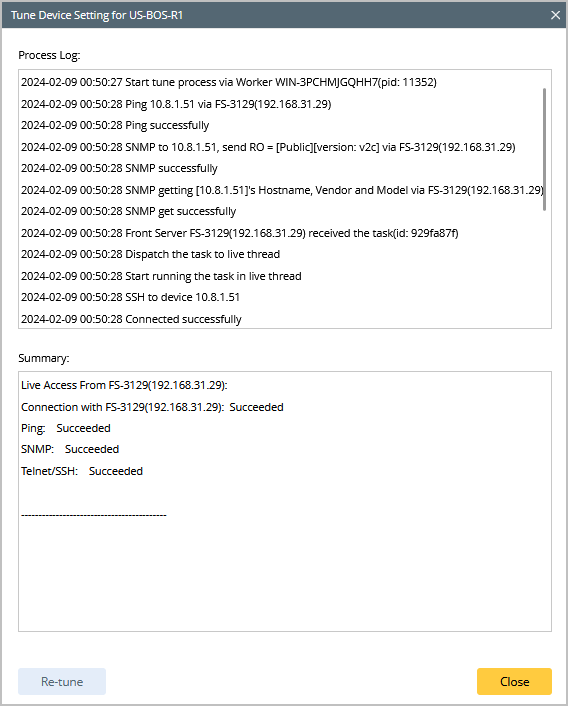

  2. Click Tune to check the reachability of live devices by using the above settings. If not reachable, the system will overwrite the settings by polling the credentials configured in the Shared Network Settings. You can view the process log and tuning results as follows.
