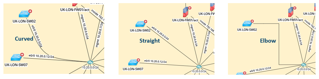

NetBrain provides three line types (Straight Line, Curved Line, Elbow) for links on map to enhance map layout and organize links more neatly.
When the device is in compact device style, three available line types are illustrated in the pictures below. Straight line is the default line type.

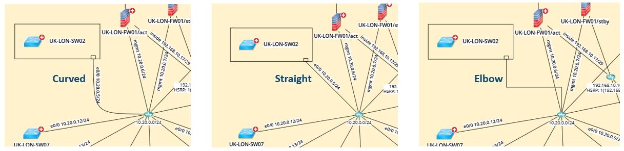

When the device is in expanded device style, three available line types are illustrated in the pictures below. Elbow is the default line type.

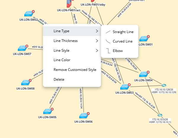

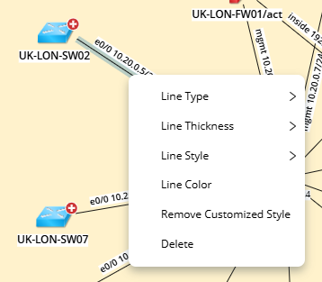

  1. Click on the link, then right-click to open the right-click menu.
  2. Select a line type from the Line Type expanded menu.
  3. You can see the link has changed to the selected line style.

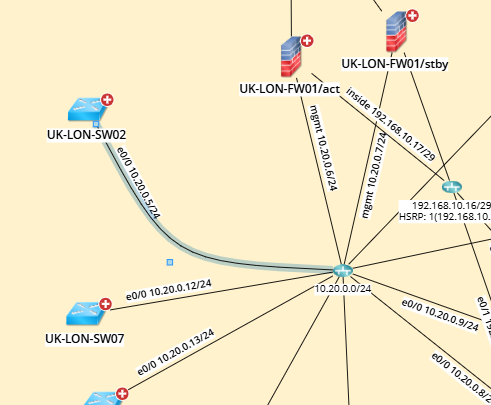

Information Note: For a curved line, you can adjust the curve by dragging the Click the mid-point handle (small diamond icon) on the curved connector and drag to adjust the curve angle.
