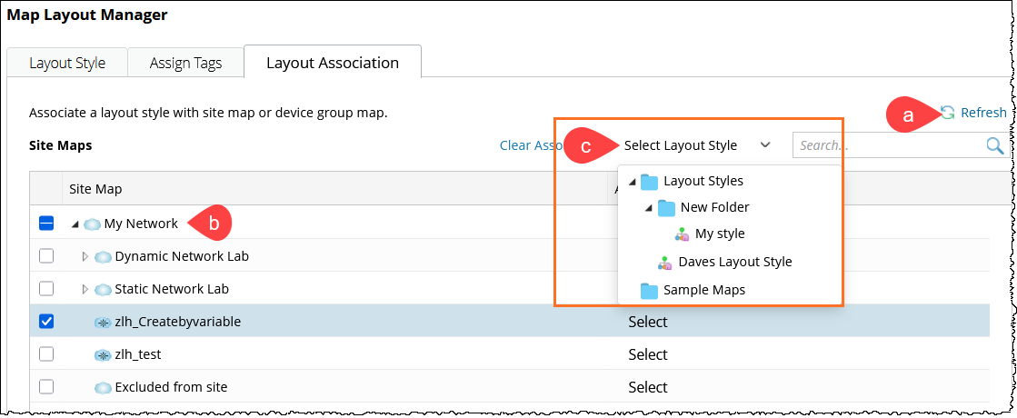

  1. Click the start menu  and then select Map Layout Manager
  1. On the Layout Association tab, associate the sample map or layout style with site maps.
    1. Click Refresh to display the newly created layout style. In the Site Maps column, expand the site tree from the My Network node.
    2. Select the site names you want to associate with the layout created above.
      Information Note: Only the maps of leaf sites () can be associated.
    3. Click the Select Layout Style dropdown and select My Style.

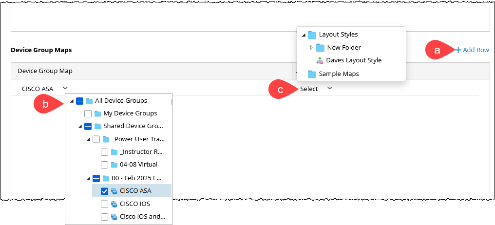

  2. Associate a sample map or layout style with Device Group Maps.
    1. In the Device Group Maps area, click Add Row.
    2. In the Device Group Map section, click Select and choose a device group.
    3. In the Associated Layout Style column, click Select and choose a layout style or sample map.
    4. Repeat the steps above to associate additional device groups.
