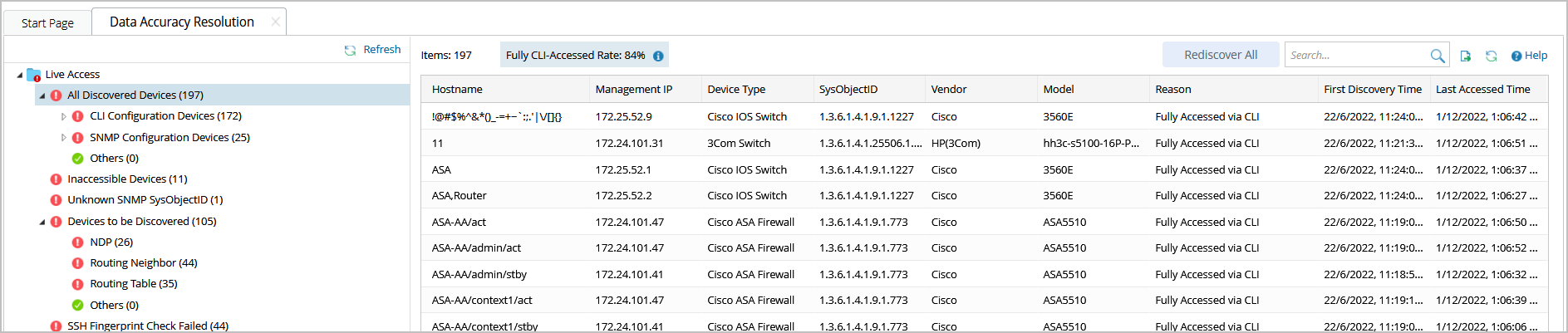

  1. Log in to Domain Management Page, and then click Data Accuracy Resolution on the Start Page.
  1. In the Data Accuracy Resolution tab, click All Discovered Devices on the left pane. All discovered devices are listed.
Based on how NetBrain retrieved the config files, devices are assigned to 3 categories: Configuration Devices, SNMP Configuration Devices, and Others.
  • CLI Configuration Devices:
    • Fully accessed via CLI indicates that NetBrain successfully retrieved the config files via the latest CLI attempt.
    • Latest CLI Configuration Retrieval Failed indicates that NetBrain failed to retrieve the config files via the latest CLI attempt.
  • SNMP Configuration Devices: Those devices are categorized by why NetBrain can only retrieve SNMP configurations.
  • Others: Devices that NetBrain failed to distinguish if they are accessed by CLI or SNMP.
