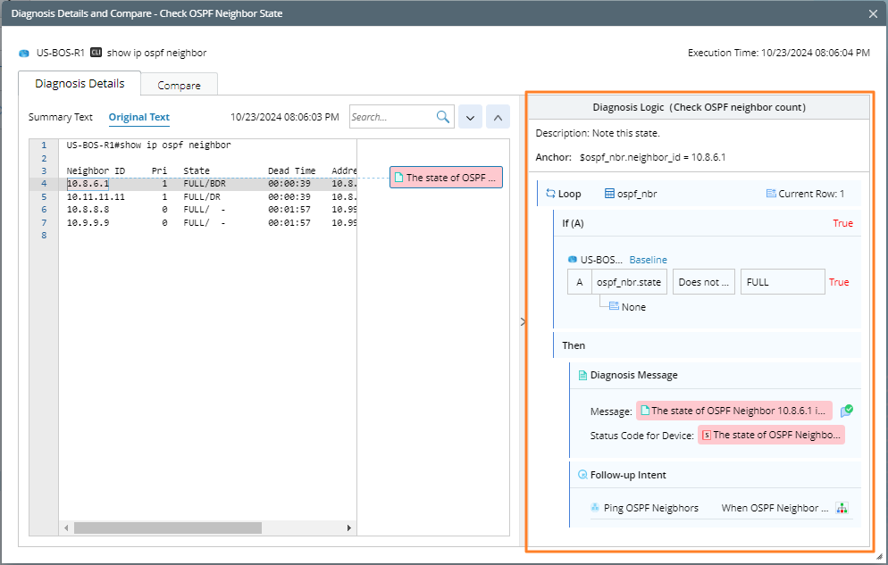

The system can display the statistics of the diagnosis defined in the current command section in the NI View mode. And you can directly view the diagnosis output and compare the original text output of all command sections in the same device in this dialog.

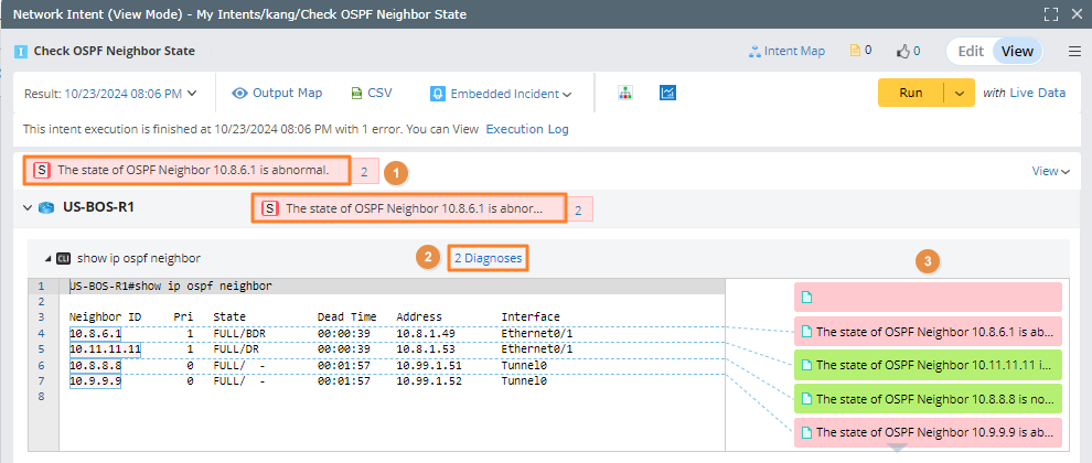

Clicking the status code, diagnosis and status code summary hyperlink, and diagnosis message to open the Diagnosis Details and Compare pane.
  • Diagnosis Details: You can view the output of the current command diagnosis in the pop-up Diagnosis Details and Compare dialog. And view the corresponding diagnosis logic pane on the right.

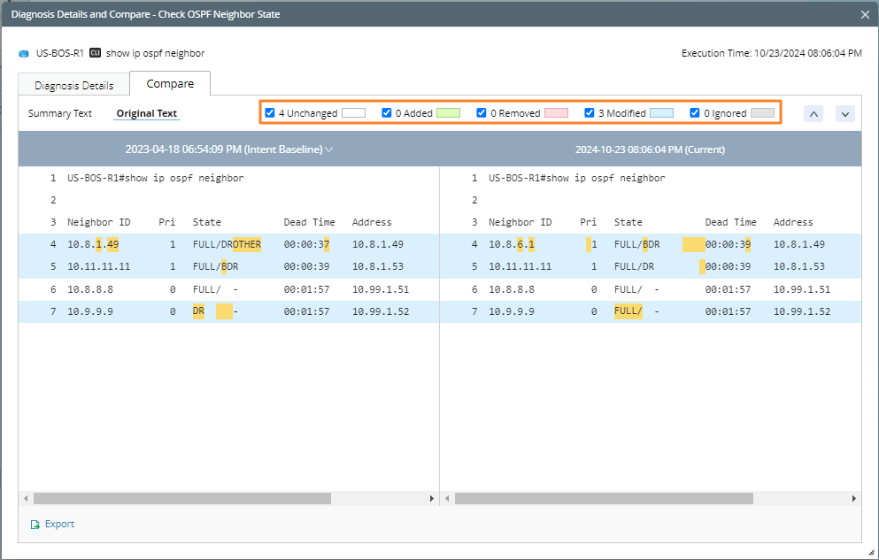

  • Compare: You can also switch to the Compare tab to view the text comparison result.
    Information NoteThe comparison result can be filtered by unselecting the check box in the upper-right corner.
