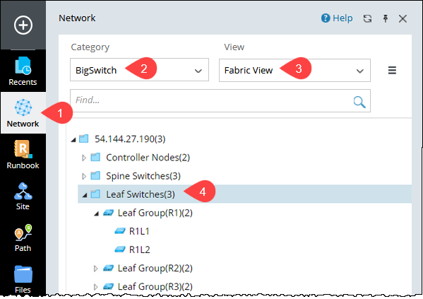

To view the details and the context maps of a node, proceed with the following steps:
  1. In the NetBrain desktop sidebar, open Network.
  2. In the Network pane, select BigSwitch in the Category field.
  3. In the View field, select Fabric View.
  4. Expand the Leaf Switches to view the Leaf Groups information.
    Information Tip: The number next to each node indicates the number of its child nodes.

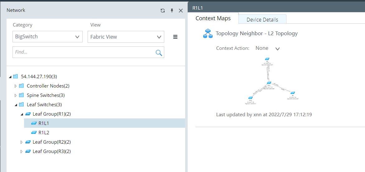

  1. Select a node and the Context Maps tab to view its context maps. The context map displays the physical topology of the switch. You can click Open Map to view the context map.
