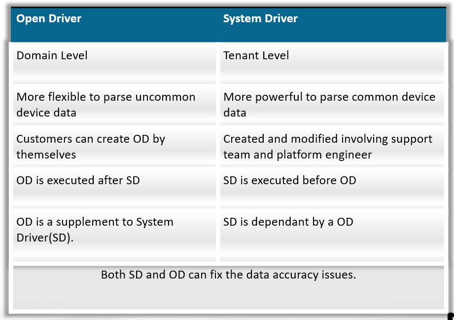

Graphical user interface, table
A user can define as many ODs as necessary for one type of device. ODs will be executed automatically after the System Driver whenever the corresponding System Driver is applied, such as in the Benchmark process.
