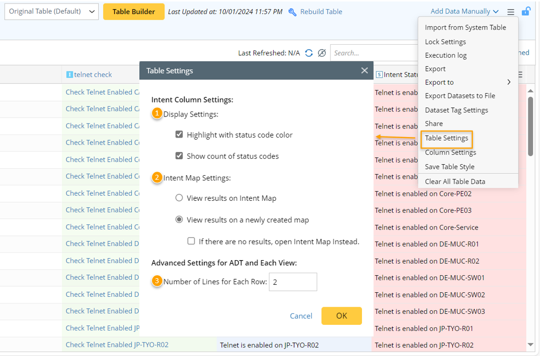

In Table Settings from the ADT main menu, you can configure more advanced settings for ADT, e.g.,  Display Settings, Intent Map Settings as well as the multiline text display.
In the Table Settings window, you can define the following.
  1. Display Settings: Define what will be indicated in the intent column.
    • Highlight with status code color: With this option enabled, the intent column will indicate the status code type by color.
    • Show count of status codes: With this option enabled, the intent column will display the count of status codes.
      Information Note: For more information, see Color Code in ADT and ADT View.
  2. Intent Map Settings: Define how to display the NI execution results on map.
    • View result on Intent Map: Display the NI execution result on the intent map.
    • View result on a blank map: Create a blank map and draw intent results on the new map.
    • If there are no results, open intent map instead: In the case where this is no intent result, open the intent map.
  3. Number of Lines for Each Row: When the cell contents are in multiline text string format, the maximum number of lines displayed for each row can be limited to optimize multiline text display. In some cases, the texts in a table cell are multiline text. To save space and display neatly arranged data, you can set the maximum lines displayed in a table row, then you can click the entry to check the full contents.
    Information Note: The default value for this field is ‘1’. The displayed lines for multiline text will decide the row height.
