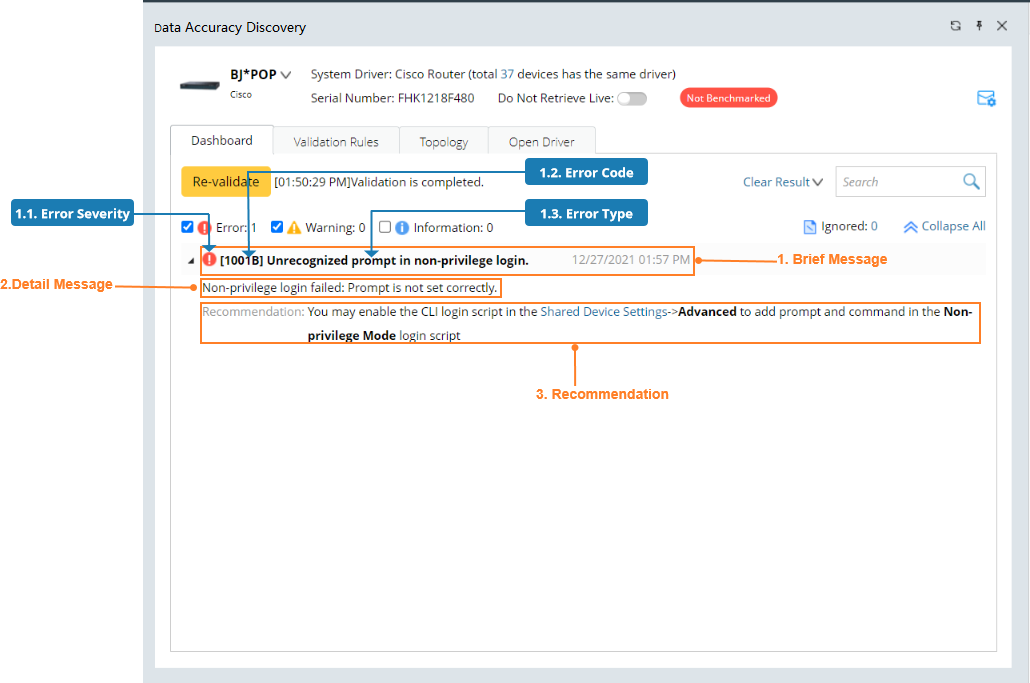

System Validation provides detailed and accurate error messages for live access issues in all features such as Discovery, Benchmark and Data Accuracy Resolution. System Validation also summarizes the live access status on devices and displays them in Data Accuracy Discovery. The error messages from System Validation are composed of the following elements : error severity, unique error code, type, detailed message, and recommendations.
The System Validation summarizes the live access failures into four major types: server error, Ping error, SNMP error and CLI error. The following table lists some of the most common errors from System Validation:
