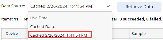

  1. Select one of the following as the data source.
    Information Tip: The Cached Data, ADT Dataset, and Cached Data(from live retrieval) enable users to retrieve data from selected testing devices once, but test the parser multiple times after each parser modification for debugging, without reduplicative live retrieval.
  • Live Data: Retrieve data from the live network.
  • Cached Data: Retrieve data from the current baseline.
  • ADT Dataset: Retrieve data from an ADT dataset.
    Information Note: ADT Dataset is not available for logic nodes in an API parser.
    1) In the Select ADT Dataset window, select the dataset column.
    2) Click OK.
  • Cached Data(from live retrieval): The retrieved data stored in the database. Each previous data retrieval will be stored and accessible in the drop-down list.
    Information Note: This is a dynamic data source and is not available during the initial retrieval.

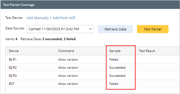

  1. Click Retrieve Data.
  2. Check the Sample column to determine whether the sample data is retrieved successfully.
    Status Data Source: Live Data Data Source: Cached Data Data Source: ADT Dataset
    Succeed Successfully retrieved data. Successfully retrieved data. Successfully retrieved data.
    Failed Attempted to retrieve live data, but with no success. Unable to find the data stored in the current baseline. Unable to retrieve data from the ADT dataset.

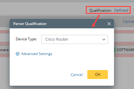

    Unqualified The device does not belong to the selected device type in the Qualification.

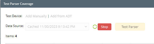

    Empty Cell The process was stopped before the data retrieval started for this device.
