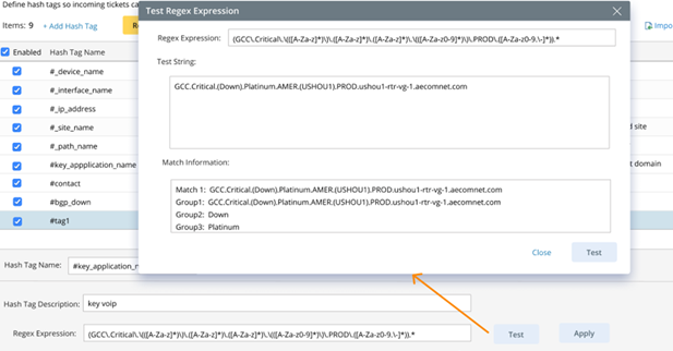

Step7: Click Save.
For example, the Hash Tag #tag1 has Primary Tag #key_application and five Associated Tags #status, #level, #city, #location and #device. You can use regular expression GCC\.Critical\.\(([A-Za-z]*)\)\.([A-Za-z]*)\.([A-Za-z]*)\.\(([A-Za-z0-9]*)\)\.PROD\.([A-Za-z0-9.\-]*).* to match the Primary Tag and Associated Tags.
Step 7:  After entering the regular expression for the regex match, click Test to test the regular expression. For this example, you can test with sample data from the ticket GCC.Critical.(Down).Platinum.AMER.(USHOU1).PROD.ushou1-rtr-vg-1.aecomnet.com. The match information will be displayed in the box below. The subgroups extracted from the original ticket data field will be the Hash Tag value for Associated Tags.
