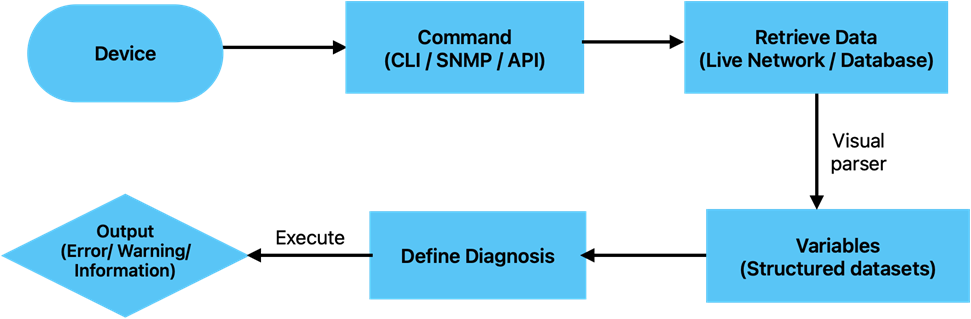

A standard NI has the following key components:
  • Device(s): An intent is specific to a device or a set of devices. The intent is designed this way so that it can include the current, last, and baseline data.
  • Raw data: The data can be retrieved from devices by the CLI, SNMP, and API.
  • Parser: The Visual Parser transforms the raw data into structured datasets. These datasets serve as the input for the diagnosis. Visual Parser is the UI-based for users without any programming language to create one.
  • Diagnosis: The diagnosis defines rules or conditions to evaluate different aspects of the network and the status code (the output) for different conditions. Users can then specify the appropriate actions or recommendations to be executed based on the status codes.
So, an NI takes a device and a command (CLI/SNMP/API) as the input, retrieves data from the live network or database, parses the data into the structured datasets (variables), runs the diagnosis on these variables, and outputs the network status (error/warning/info).

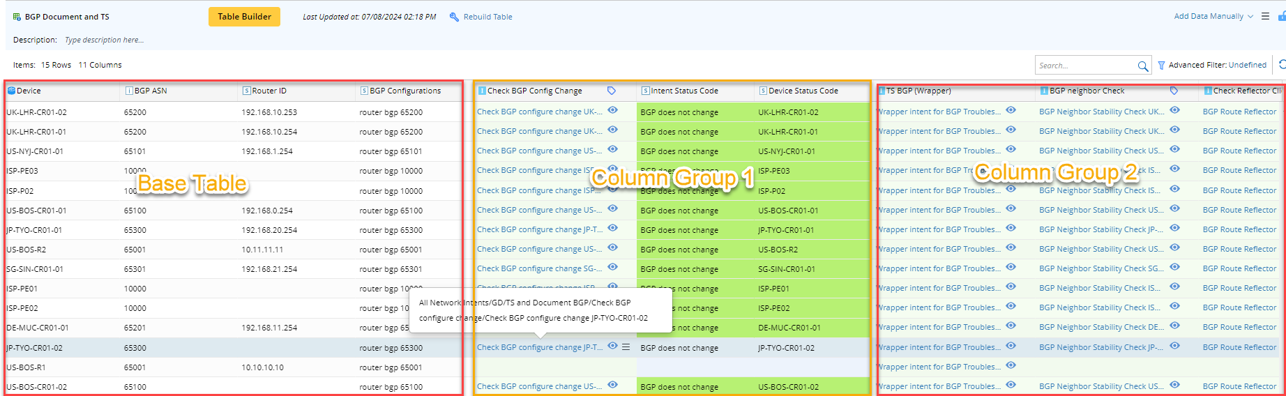

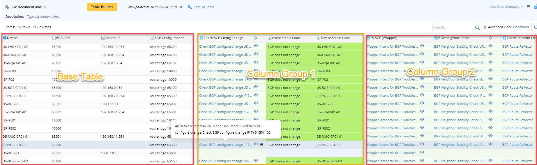

An ADT contains a base table, which can be the critical assets and be built from the device group, sites, application table, intent template, and CSV file, and many Column groups, which are associated with the intent and results and can be replicated primarily from the intent template. A feature table is a special ADT that is automatically created for a Golden Feature.
The following is an example of an ADT table showing all BGP devices and intents associated with the BGP devices:

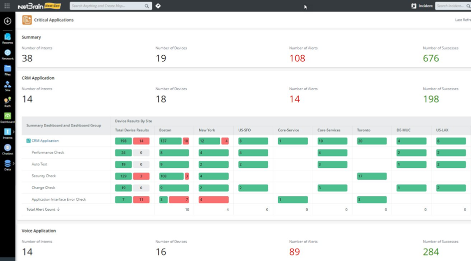

 An individual intent or the intents of an ADT can be run manually (e.g., running intent in the map while troubleshooting a network issue) or be scheduled to run (e.g., continuously monitoring the configuration drift). The results can be viewed in the post-execution tree of intent or through a Dashboard. A dashboard provides a network-wide observability of your network status created by the intents.
