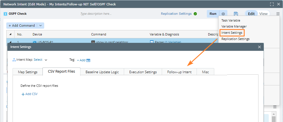

- In NI Edit Mode, click the
icon and select Intent Settings in the drop-down menu.

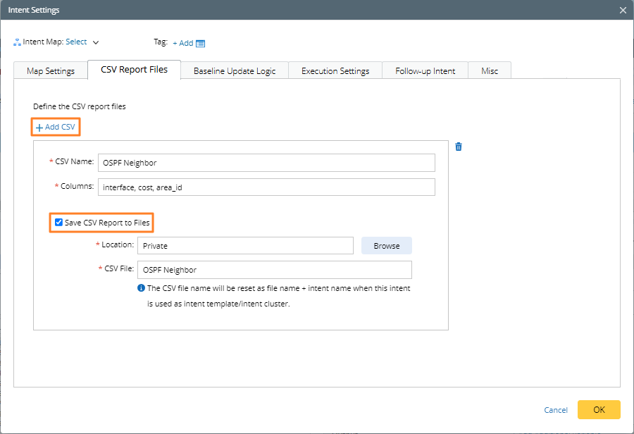

- On the CSV Report Files tab, click Add CSV to define the file name and columns for the CSV report. You can click Add CSV to define multiple CSV reports for the NI.
- Select the Save CSV Report to Files check box to specify the NetBrain files folder for CSV report from intent.

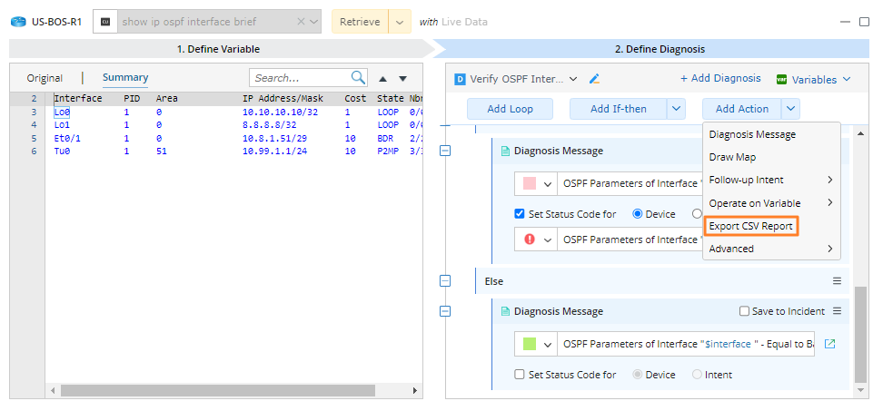

- On the Define Diagnosis tab, click Export CSV Report from the drop-down list of Add Action.

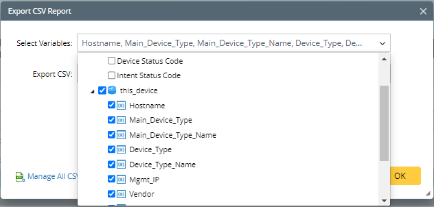

- In the pop-up window, select variables to define the column mapping from the single value to the selected CSV Report.

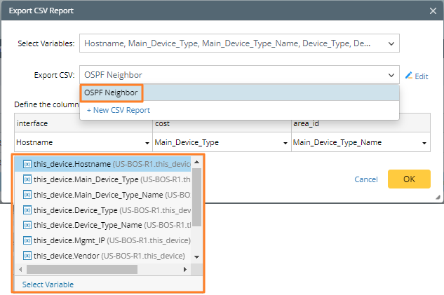

- Select the CSV report defined previously, and then use the drop-down menu to select the variable for each column in the CSV report. Click OK. Built-in data can be selected and exported, such as device name, diagnosis note and device status code.

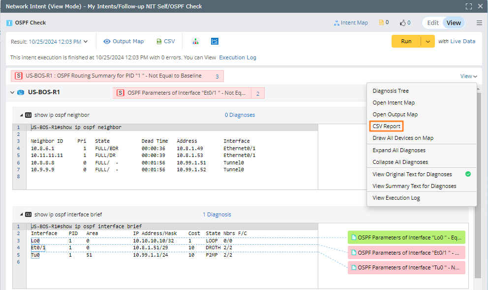

- Run this intent and in NI View Mode, click View > CSV Report to view the generated CVS report.
- In the Export Reports dialog, select the report you want and click Export and select CSV as export fotmat. You can directly download the report to the local folder or save the report in the NetBrain system.
