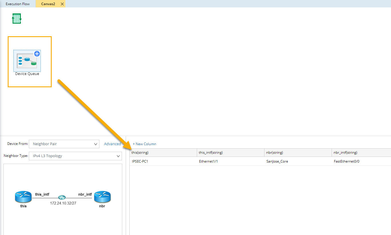

At this node, you can define the pattern to load input devices to the Device Queue:
  • Device — loads devices in a single device pattern and each device is an independent individual in the Device Queue.
  • Neighbor Pair — loads devices in pairs and each pair is a pair of neighbor devices. This Device Queue pattern is often used to compare the difference of a device and its neighbor, such as MTU and Duplex mismatch.
  • Path — loads devices in hop pattern. Each hop contains a device, the incoming interface and outgoing interface. If you select the Calculated Path option at the Start node, the Path option here is selected by default.
  • Table — load devices from a specified table and the pattern to build devices depends on the definition of the imported table. If you select the Table option at the Start node, the Table option here is selected by default. The specific table you can select is defined in the Global Table.

  1. Click the Device Queue node on the Canvas tab.
  2. Select the device input from the Device Input drop-down list. There are four options as follows:
  • Device
    1. Click the drop-down menu of Device From and select Device.
    2. Click Advanced to configure whether to include interface information in the device queue based on your needs.
  • Neighbor Pair
    1. Click the drop-down menu of Device From and select Neighbor Pair.
    2. Specify the type of neighbor pairs (such as this and nbr in the device queue table) from the Neighbor Type drop-down list.

    8. Whether to include interface column:
      Do not include interfaces — default option.
      Include Interfaces — adds a new interface column (such as $_intf) in the device queue table at the right side.
