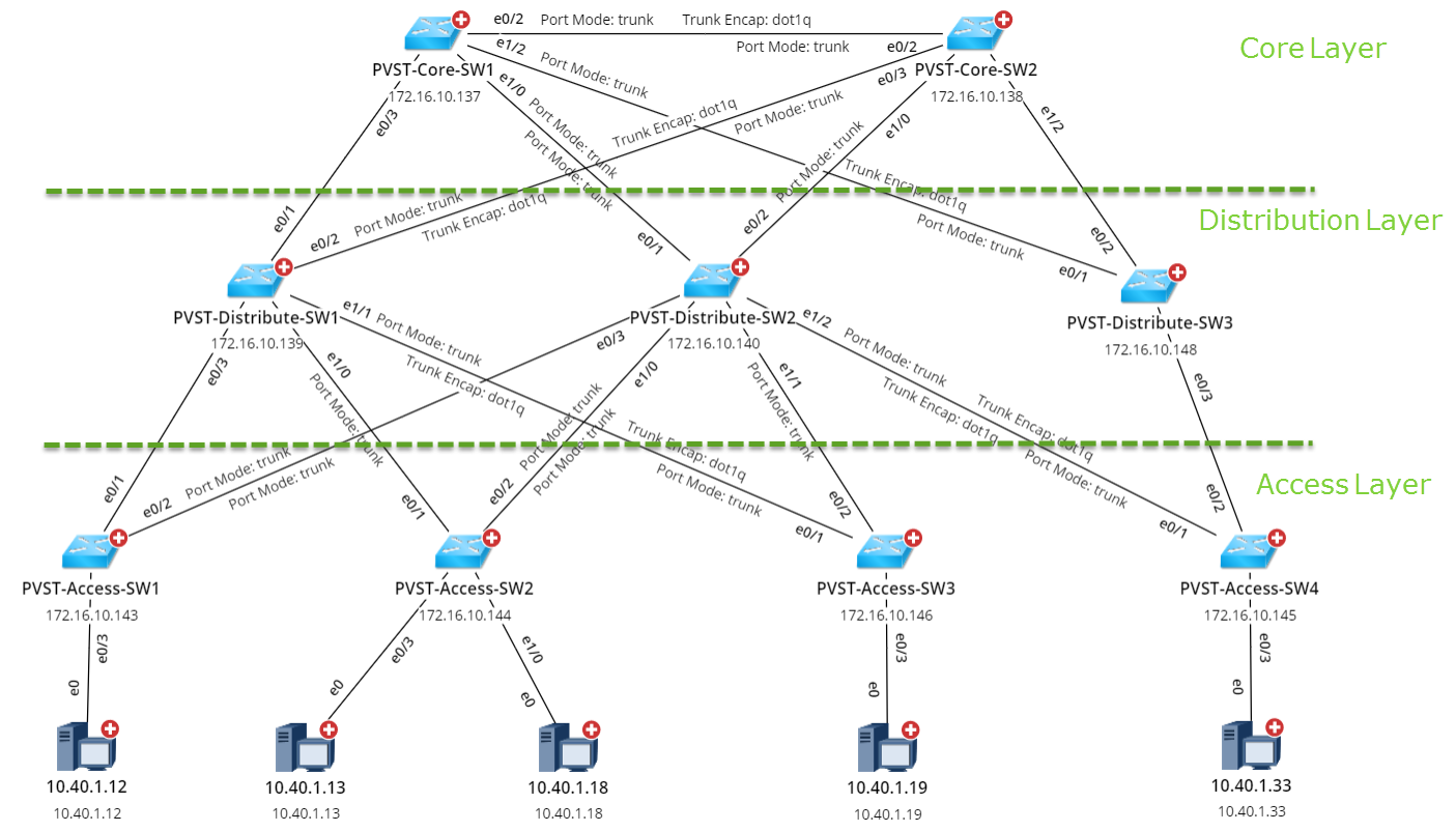

Create a Layout Style Using Tags
To represent a realistic network infrastructure, organize devices by their roles using a map layout. For instance, the layout below is structured into three hierarchical layers to reflect the network topology.
Diagram, mapDescription automatically generated

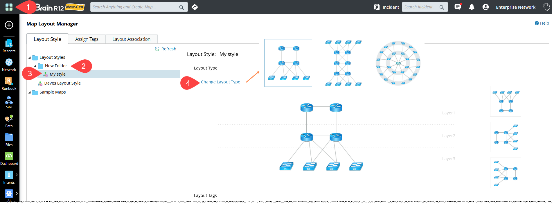

  1. Click the start menu  and then select Map Layout Manager.
  1. On the Layout Style tab, right-click the Layout Styles node, and then select New Folder.
  2. Right-click the new folder and then select New Layout Style. Enter a style name, My Style.
  3. In the Layout Style area, click Change Layout Type to select a layout type suitable for your three-layer network.
    Information Tip: To change the layout direction, click a thumbnail next to the selected layout type diagram.

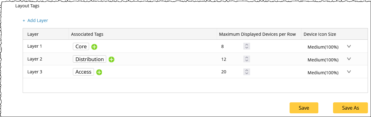

  4. In the Layout Tags area, add tags to the layout type. Tags are used to mark devices and layout layers to identify which layout layer a device belongs to.
    1. For each layer, click the icon to create a layout tag. Enter core, distribution, and access as tag names, respectively. The tags will be used to associate layout layers with devices.
    2. Set the maximum device number in each row of a layer and the device icon size.
    3. Click Save.

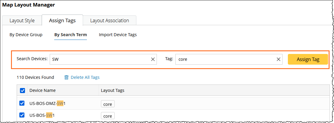

  5. On the Assign Tags tab, assign layout tags to devices based on their role in your network. For example, if a device is in the core layer, assign the layout tag core to the device.
    Information Tip: To delete tags from devices, you can click Delete All Tags to remove all tags, or point to the target tag in the Layout Tags column and click the icon to delete the tag one by one.

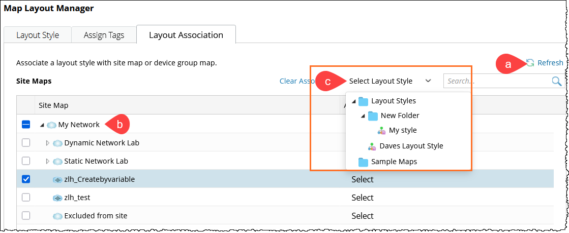

  6. On the Layout Association tab, associate the layout style with site maps.
    1. Click Refresh to display the newly created layout style. In the Site Maps column, expand the site tree from the My Network node.
    2. Select the site names you want to associate with the layout created above.
      Information Note: Only the maps of leaf sites  () can be associated.
    3. Click the Select Layout Style dropdown and select My Style.
