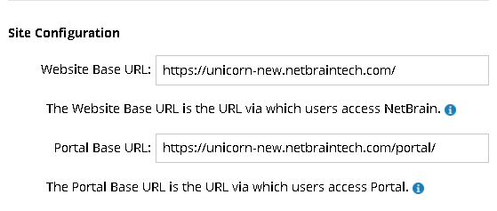

To configure the base URL of the NetBrain System and portals, do the following:
  2. Select the Advanced Settings tab, go to the Site Configuration area and set the base URL.
    • Website Base URL — the URL via which you access the NetBrain System.
      Information Note: Website Base URL must end with "/".
    • Portal Base URL — the base URL via which you access a portal.
      Information Note: Portal Base URL must end with "/".
  1. Click Save.
