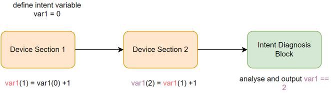

Along with global variables, intent diagnosis block provides a way to support:
  • Analyze logic on a few previous device sections and use the intent diagnosis block to loop through the intent table to output the final diagnosis, including NI status code, diagnosis message, CSV report, or trigger follow-up.
  • Intent-level diagnosis - handle ADT update and ADT-based follow-up intent (using Macro and Intent Variable to match intents inside ADT).
You can define a global variable that can be reached and modified in the intent:
  • Add/remove/update the table row and use the data row of this table.
  • Define the singleton variable with an initial value and update the value in the device diagnosis.

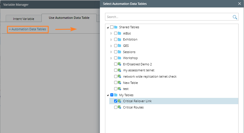

  1. Define Critical Failover Link ADT.
  2. Build intent to define an ADT-based diagnosis. Define intent variables and intent table.

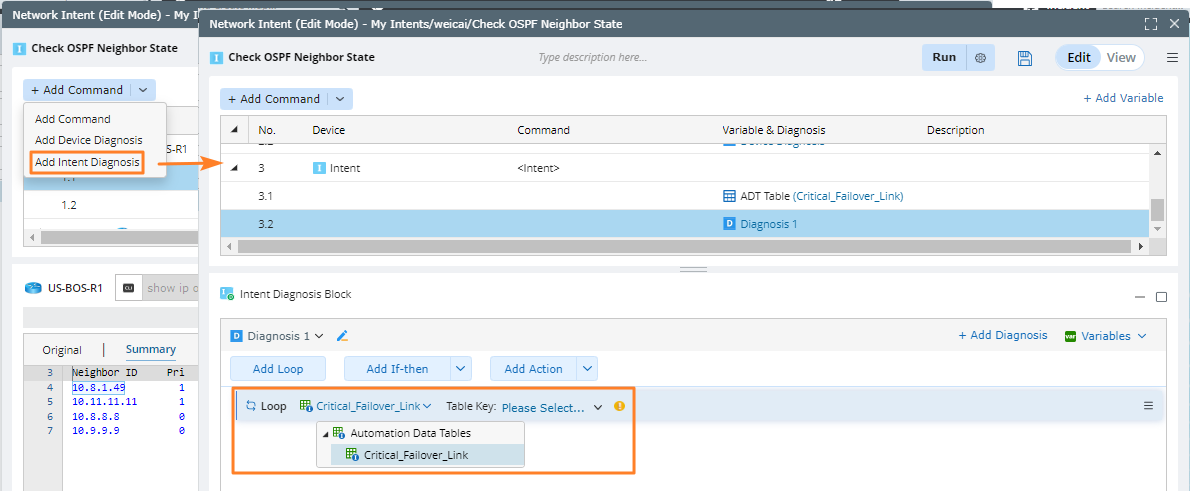

  3. Define an intent diagnosis block to loop the ADT (no need to input device) as follows:
    1. Click the  icon in the Intent Edit Mode and select Add Intent Diagnosis Block.
    2. Select the Loop Table Rows check box, then select the created ADT.
    3. You can also add status code or more logics for the intent.

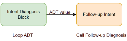

  4. Define a follow-up intent template to detect if the failover states of the primary/secondary devices have changed.
