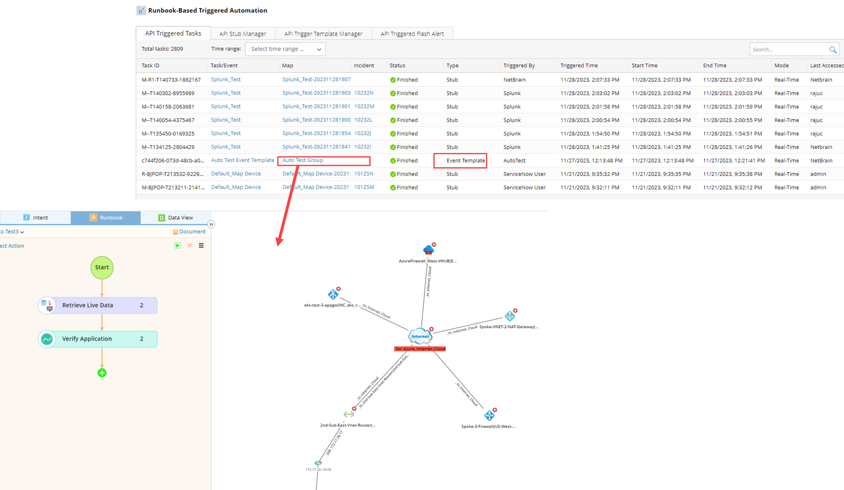

API Triggered Tasks contain all API call task instances and relevant information from the integrated third-party systems. The system generates an API task instance for every incoming API call.
  1. Log in to the NetworkBrain system.
  2. Click the start menu, and select Map-Based Automation > Runbook-Based Triggered Automation
  3. Click the API Triggered Tasks tab.
    Information Tip: You can click  to refresh and view the latest results.
  4. View the triggered tasks.

    MapOpened or generated map defined in Event Template. Click it to open the specific map page.

  5. Click the map hyperlink of the triggered task to view the created map as well as the data collected by the runbook (as long as you have added a runbook when defining the task).
