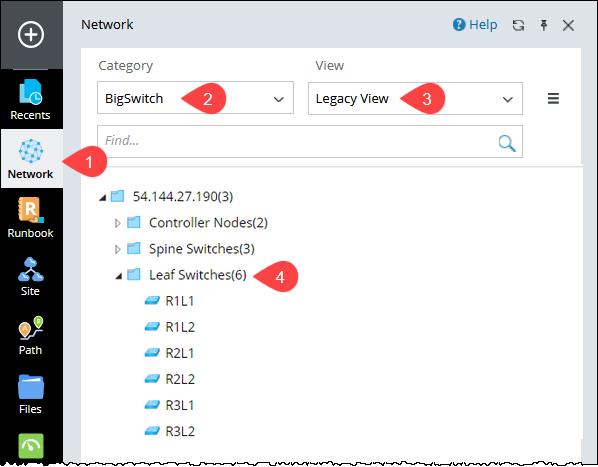

To view the details and the context maps of a node, proceed with the following steps:
  1. In the NetworkBrain desktop sidebar, open Network.
  2. In the Network pane, select BigSwitch in the Category field.
  3. In the View field, select Legacy View.
  4. Expand the Leaf Switches to view Switches information.
    Information Tip: The number next to each node indicates the number of its child nodes.

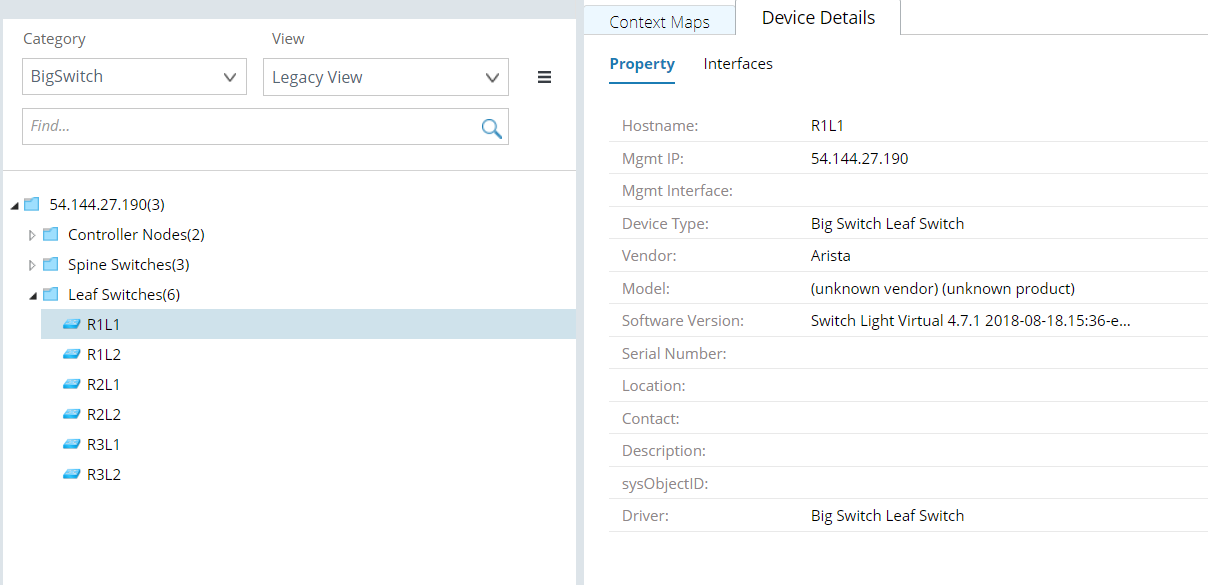

  1. Select a node and the Device Details tab to view its device details.
