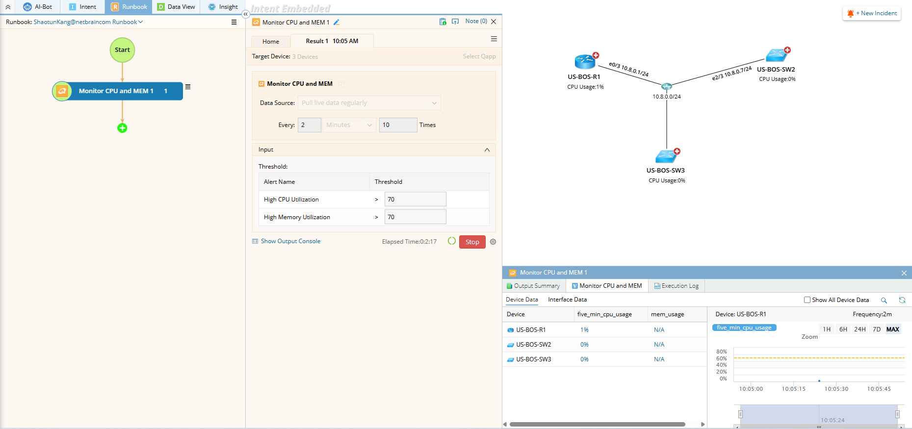

Example: Run the built-in Monitor CPU and MEM Qapp from a map.
  1. On a map, select Run Qapp from the right-click menu.
  2. In the Select Qapp dialog, select the Monitor CPU and MEM Qapp, and click OK.

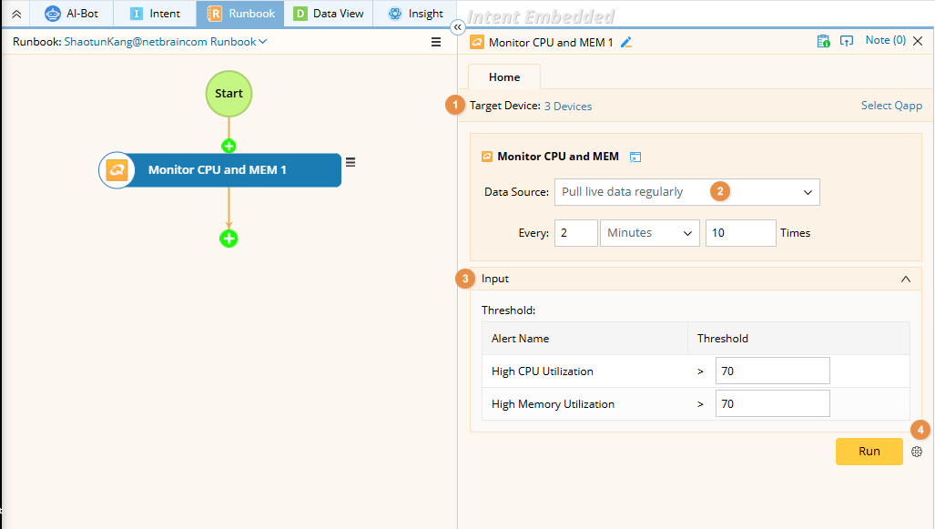

  3. (Optional) Before running the Qapp, configure the following settings:
    1. Click the device link in the Target Device area to customize target devices. By default, all devices on the current map are auto-populated.
    2. Click the Data Source field to select Pull Live data regularly and define the frequency.
    3. Customize inputs for the listed Qapp, including threshold values of key variables.
    4. Click the icon to configure the settings for sharing alerts.
  4. Click Run.
  5. Browse the data view applied on the map and detailed output results in the Output Console.
