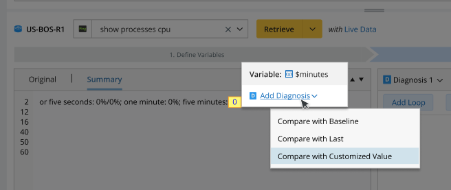

Quickly Add Diagnosis with Template

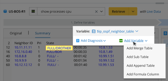

You can add diagnoses with the template by selecting a variable in the command result.
For example, you can select a table variable, and then select Compare with Baseline, a diagnosis is automatically defined based on the predefined rules.
Information Note: You can also add variables here.
When you select a single-value variable, the dialog will also pop up.
The related information of the diagnosis template is summarized as follows:
Variable TypeSupported TemplateDefault Diagnosis
Table
Compare with Last
Compare Table
Table Column
Compare with Last
Compare with Customized Value

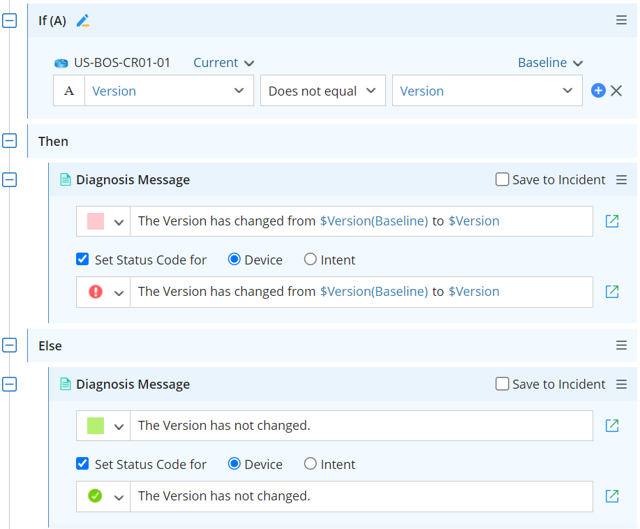

Local Variable
Loop
   If
     Diagnosis Message (Alert)
   Else
      Diagnosis Message (Success)
If
Single Variable
Compare with Last
If
  Else
