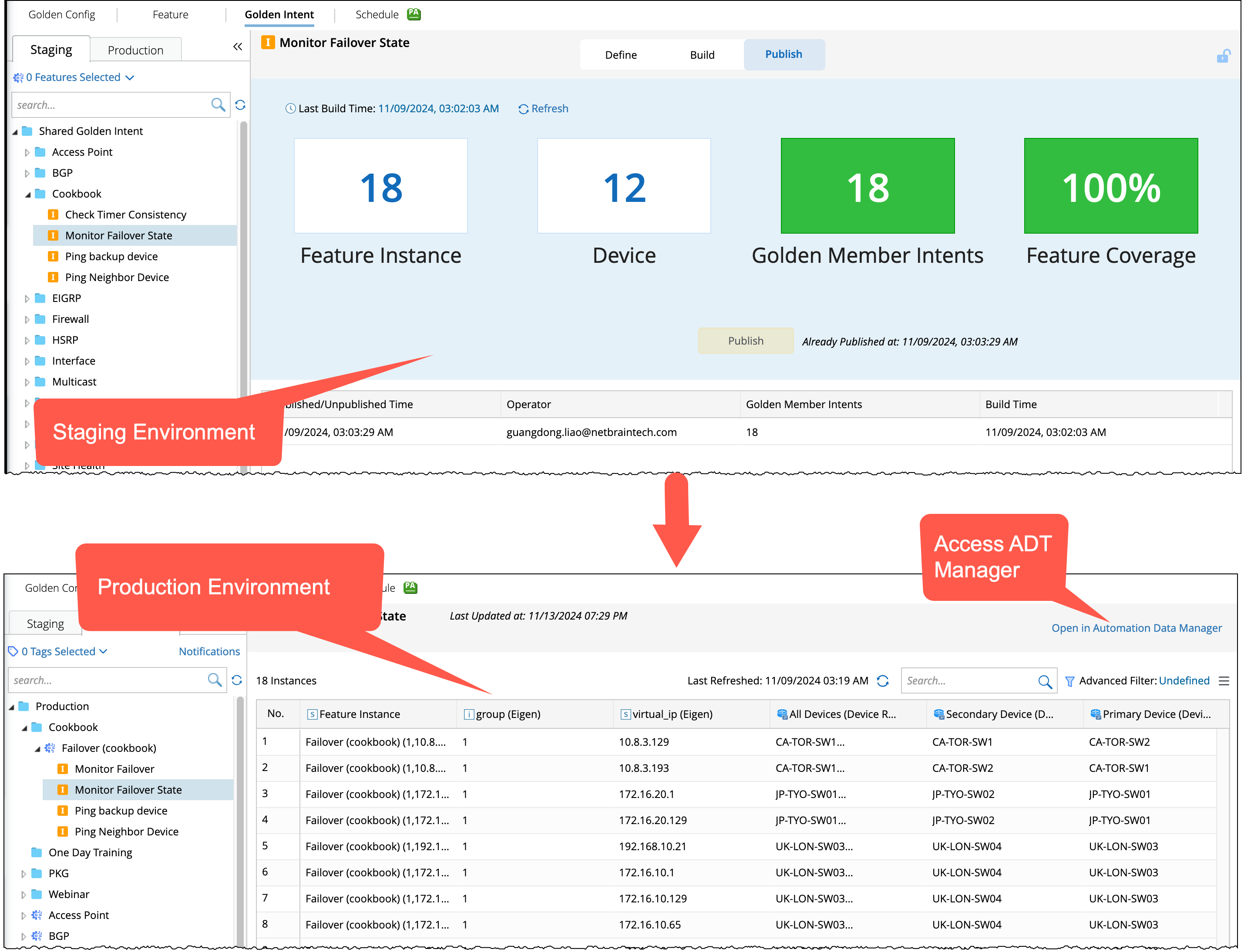

Publish Golden Intent
Upon building the golden intent, switch to Publish mode. The published golden intent will appear in the Production tab. In the production environment, you can view the feature details and the related golden intent for each feature instance (also called as Feature ADT).

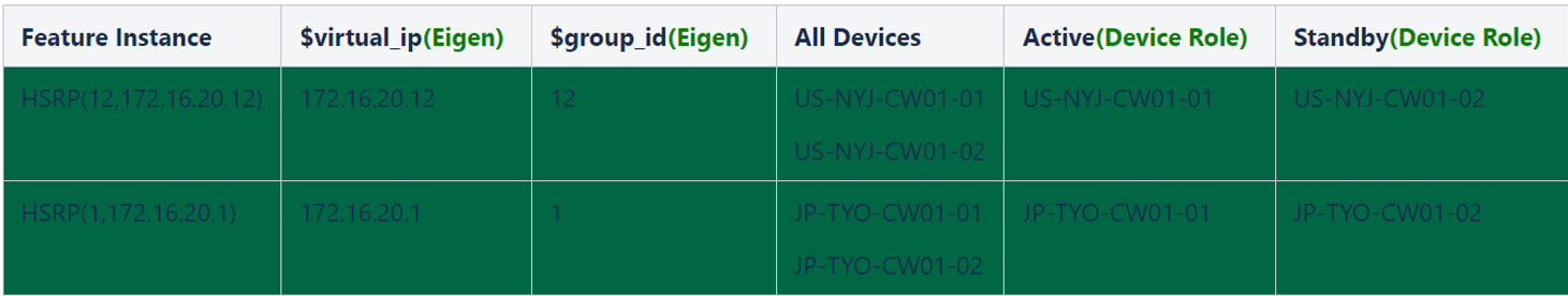

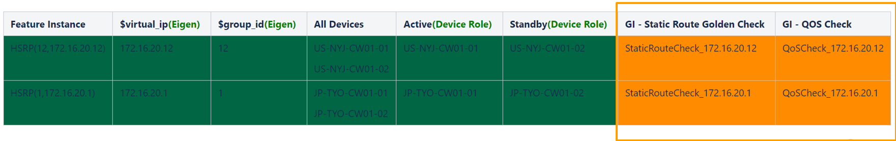

  • When you publish the golden feature, a feature ADT data structure will be created in the backend.
  • As you define new golden intents and publish, more intent columns will be added to the feature ADT.
  • The published golden intents can be accessed from the ADT Manager under the folder Feature Tables.
