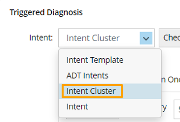

  1. In the Intent field, click the icon, then select Intent Cluster

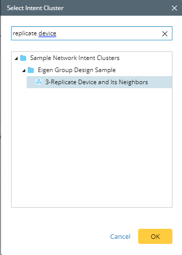

  2. Click Select. In the Select Intent Cluster dialog, enter search keyword to find the proper NIC, then select the NIC 3-Replicate Device and its Neighbors
  3. Click OK

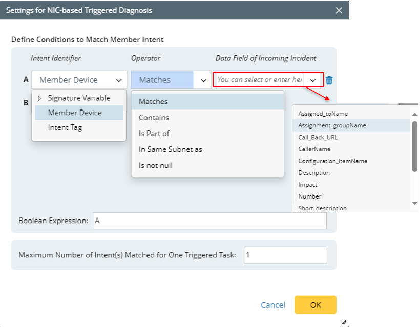

  2. Define Conditions to Match Member Intent: Define one or more conditions for triggering the diagnosis by matching the member intent properties with the data fields in the incident type used for this triggered diagnosis.
    Information Note: If no condition is defined, then NO member intent will be triggered.
  • Select Intent Identifier: Select the identifiers for the Signature variable, Member Device, or Intent tag for matching.
  • Select Operator: Select a matching logic, for example Matches
  • Select Data Field of Incoming Incident: Click , then select a data field of the incident type for matching the intent from the drop-down list.
    You can repeat this step to add more conditions (B, C, ...).
  • Define Boolean Expression: The system will automatically input the Boolean Expression (if only one condition is defined, it will be "A"; if multiple conditions are defined, it will be like "A and B").

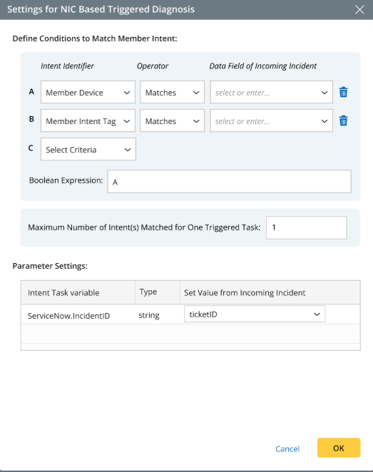

  • Maximum Number of Intent(s) Matched for One Triggered Task: Input a maximum number. This option determines the maximum member intents that can be matched for one trigger. For example, setting the number to "10" means up to 10 intents can be matched. If you want to match only one intent, you can set the number as 1.
  1. Set Parameter Settings: To define the task variable, click from the Set Value from Incoming Incident field and select an incoming incident value (for example, ticketID) as the task variable value.
  2. Click OK in this dialog to save the settings and close the dialog.
