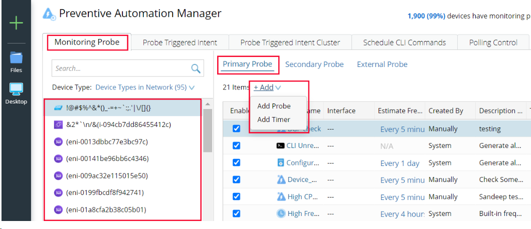

  1. Click  on the task bar and select Preventive Automation Manager from the menu.
  2. Click the Monitoring Probe tab and Primary Probe tab, select the target device on the left and click +Add. From the drop-down list, select Add Probe.

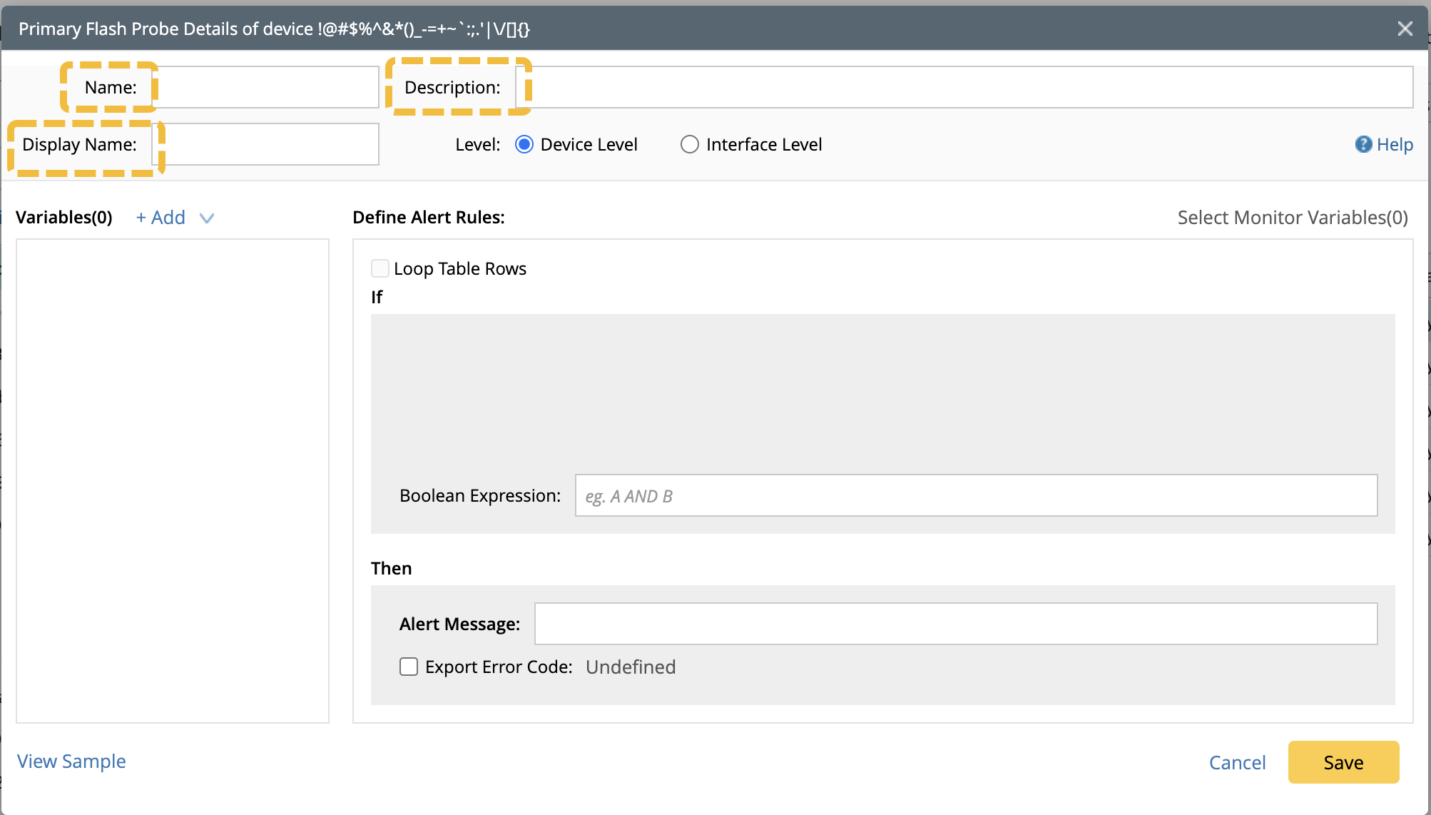

  3. Define the basic information, such as the Name, Display Name and Description of the flash probe.

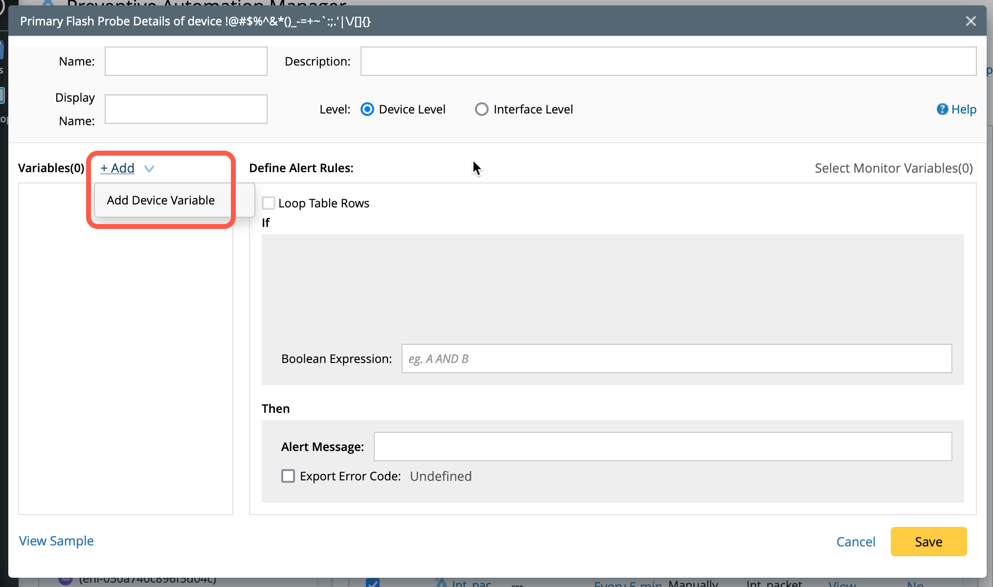

  5. To define the variables that need to be monitored, click +Add to add variables.
    • When the level is set at Device Level: Choose Add Device Variable from the drop-down menu.  Search the variable by the keyword (of the variable or command) and select the variables. Click OK.

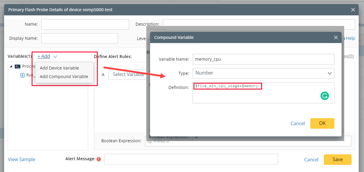

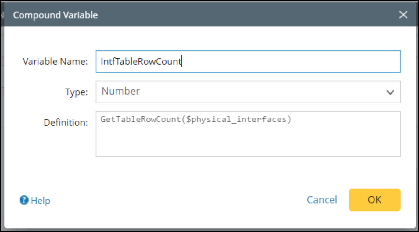

      Once a variable is added, you can choose Add Compound Variable from the drop-down menu.
      Graphical user interface, application Description automatically generated

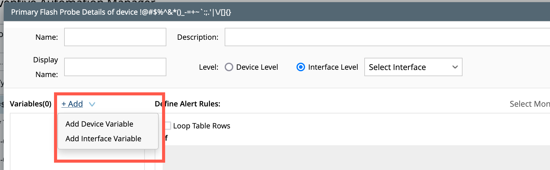

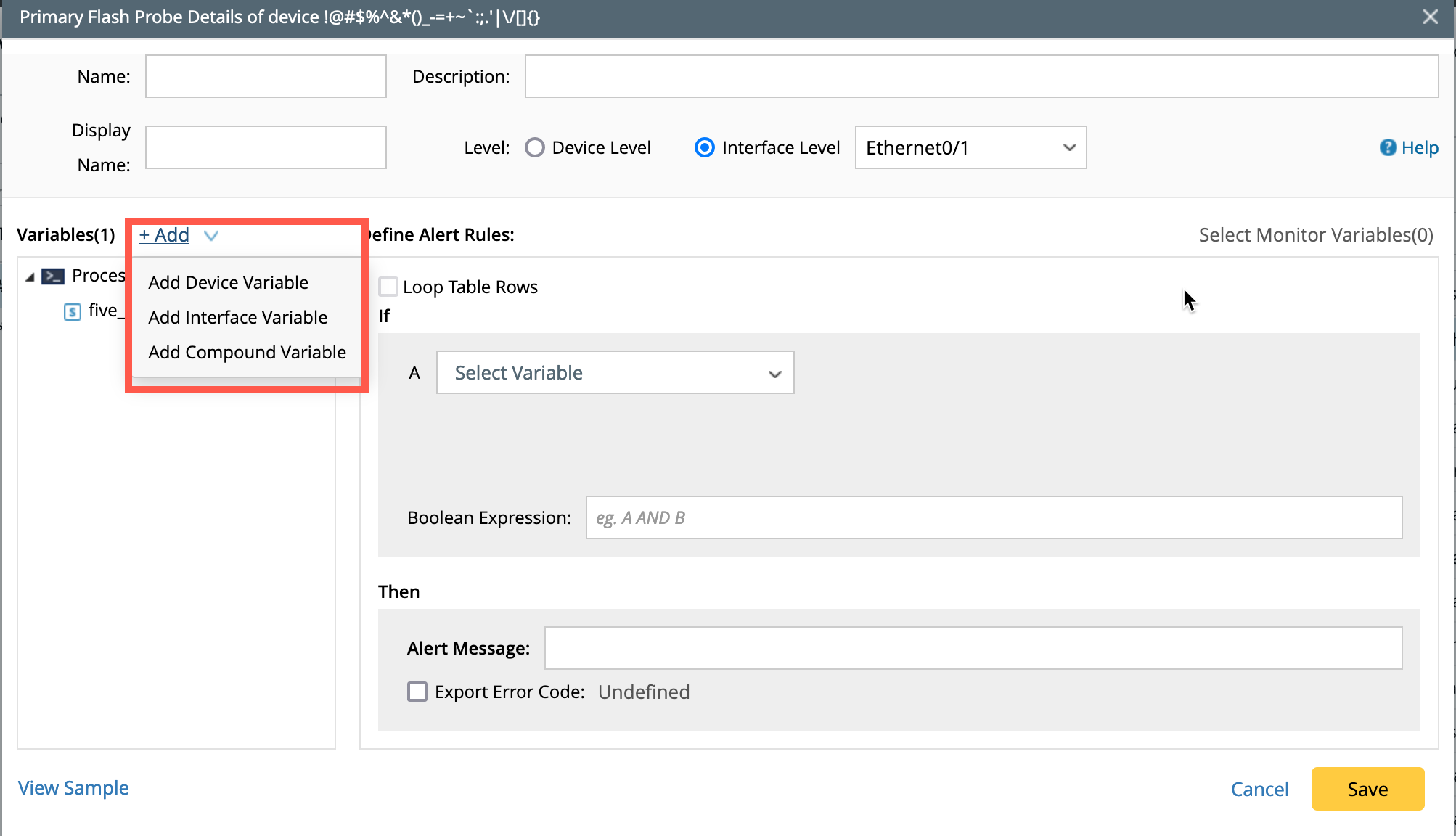

    • When the level is set at the Interface Level: Select Add Device Variable or Add Interface Variable from the drop-down. Search the variable by the keyword (of the variable or command) and select the variables. Click OK.
    • Once a variable is added, you can also choose Add Compound Variable from the drop-down.
      Information Note: If a flash probe includes multiple interfaces, all the interfaces will use the same value for the parameter to retrieve the data.
      Compound variables are designed to perform bulk operations on multiple parser variables or use function calls to retrieve a certain value.
      Example: IntfTableRowCount = GetTableRowCount($physical_interfaces)
      In this example, the compound variable is to get the table row count.

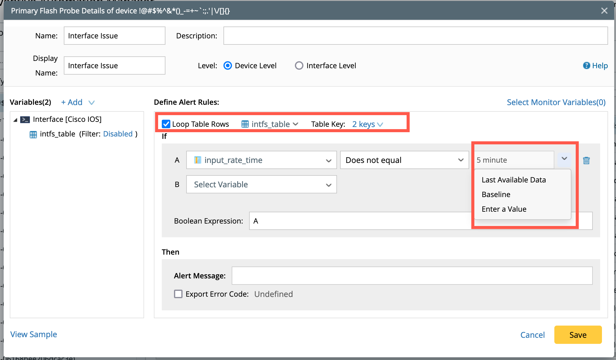

  9. Define Alert Rules:
    1. Loop Table Rows: Enable the check box and select Table Variable and then Table key. The table key compares the table rows against baseline/last values to identify unique rows.
      Information Note: This functionality is enabled only for table variables and disabled for single variables.
    2. IF condition: Compare the variables using a condition, for example: If Does not equal operand is chosen, the options would be:
      1. Last Available Data: To compare the table data with its last available information, select Last Available Data.
      2. Baseline: The current data will be compared with data retrieved for the first time which is a baseline data.
      3. Enter a Value: Manually define the value, for example select a variable (input_rate_time), condition (Does not equal) and enter a value such as 5 minutes.

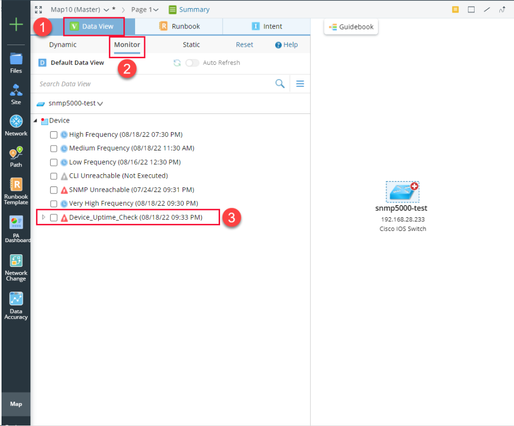

  10. Select Monitor Variable: If you wish to save the historical data for essential variables, click Select Monitor Variables and select the variables. The historical data will be saved in Monitor Data View.

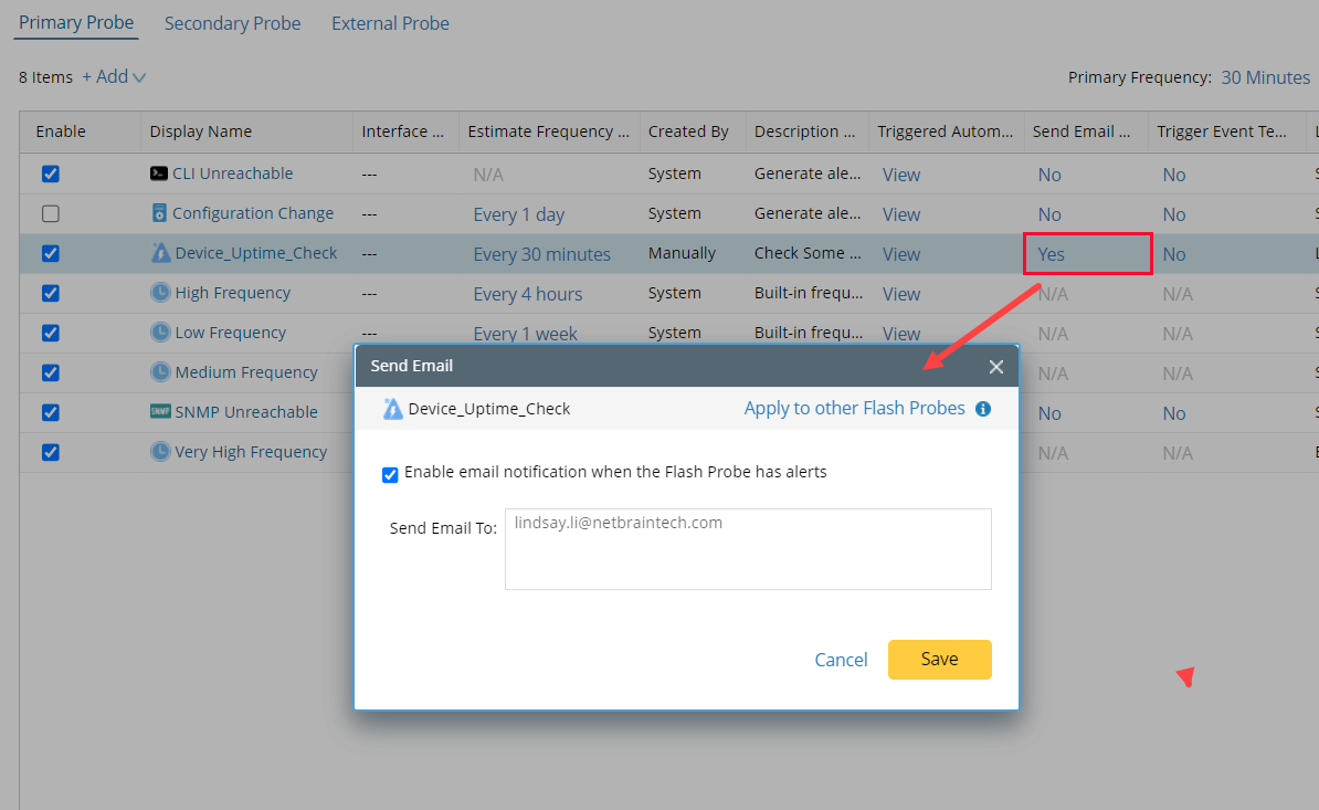

  12. Enter the Alert Message: The alert message will be displayed in the  Execution Tree and can be sent via email for notification purposes. In the alert message field, you can type $ to reference the variables defined in the alert rule statement. See Viewing and Understanding Execution Tree for more details.

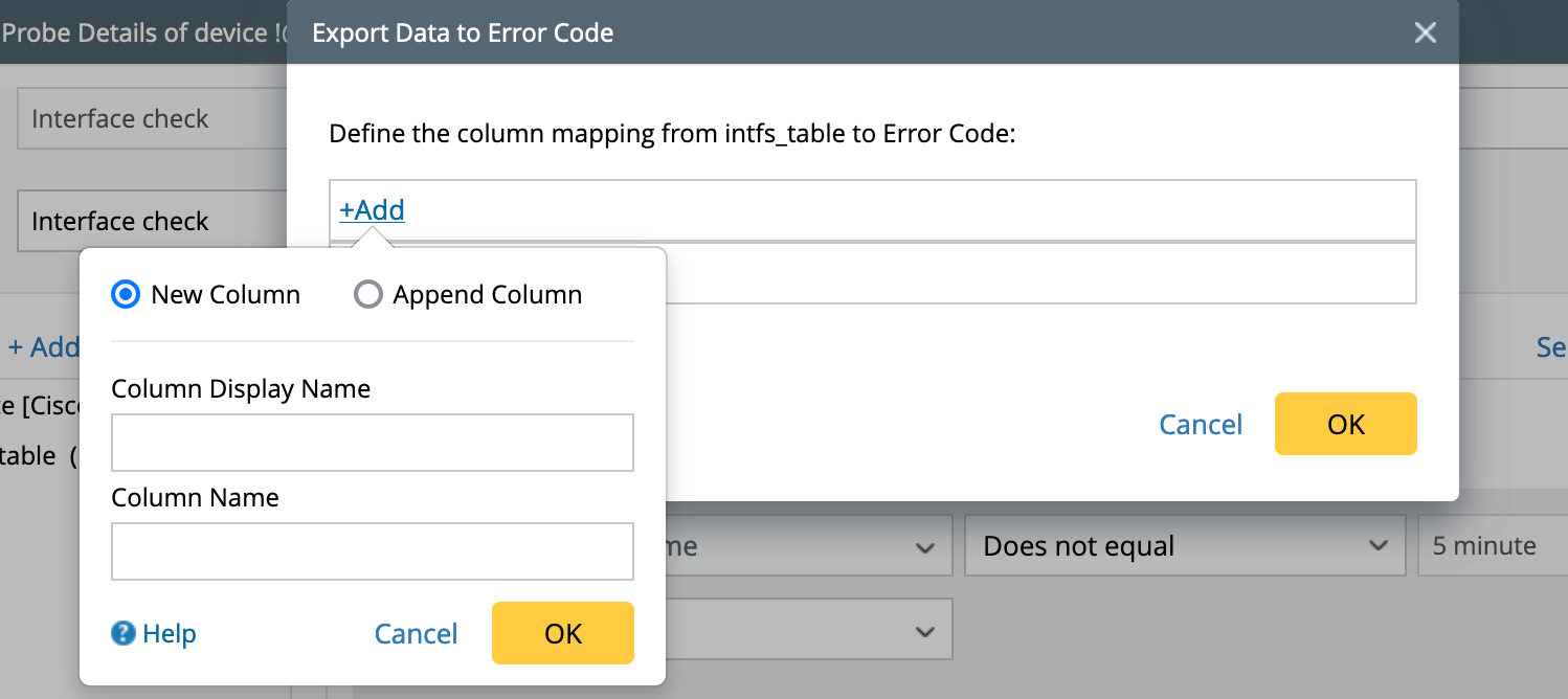

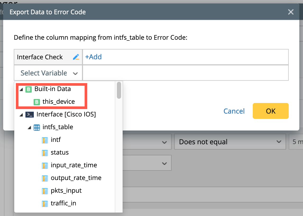

  14. Export Error Code: You can export the alert contents via the Error Code. The new error code column can be defined from the table or a single value used in the If condition as follows:
    1. Enable the Export Error Code option using the check box and click on Undefined to open the popup window Export Data to Error code.
    2. Click on +Add and you will find options to add a new column or append column from ADT/Function.
    3. Select New Column and:
    4. Append column via ADT Table/Function:
      1. Enter the Column Name and click OK.
      2. Select a variable either this_device or any of the single variable from the current device and click OK.
      3. Information Note: Choosing this_device is very much useful when you have multiple looking glass devices and want to define match conditions based on looking glass devices.

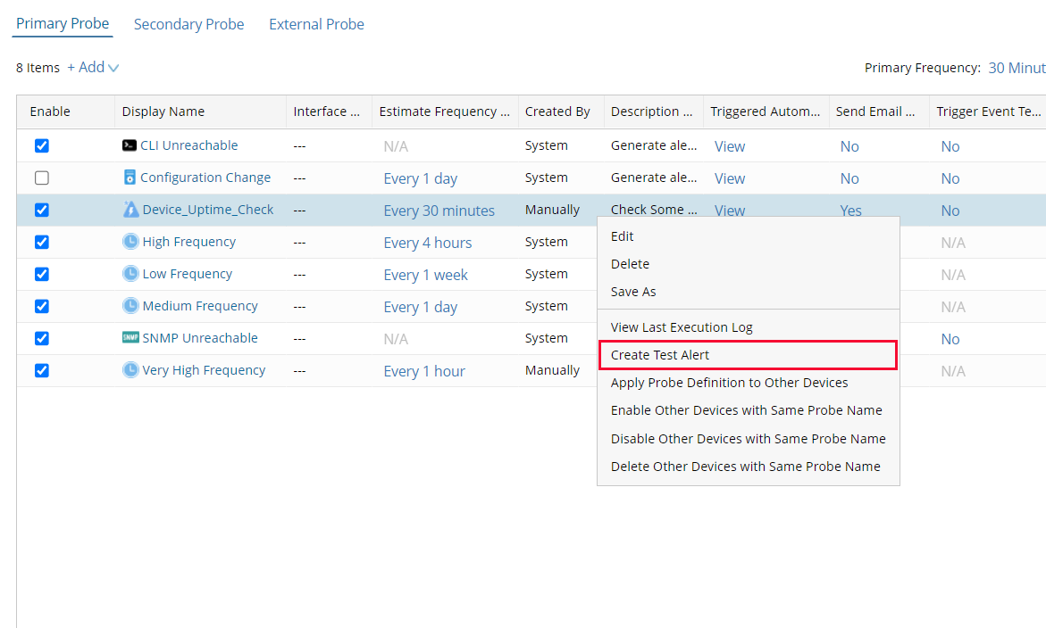

  15. Test the Alert message:
    Without executing the flash probe in a real network environment, you can have the system send you a test alert to see if this function works properly. The test alert is only in the Execution Tree as well. See Viewing and Understanding Execution Tree for more details.
