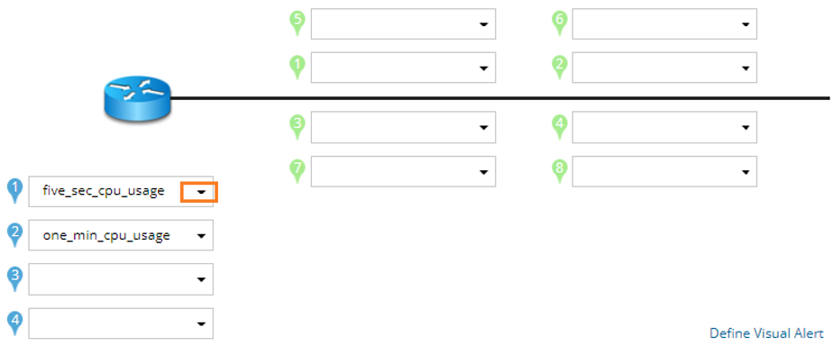

  2. At the Data View node, click Select Data UnitItems.
  3. In the Select Data Unit dialog, select five_sec_cpu_usage and one_min_cpu_usage and then click OK.
  4. Customize the display positions for these variables on a map.

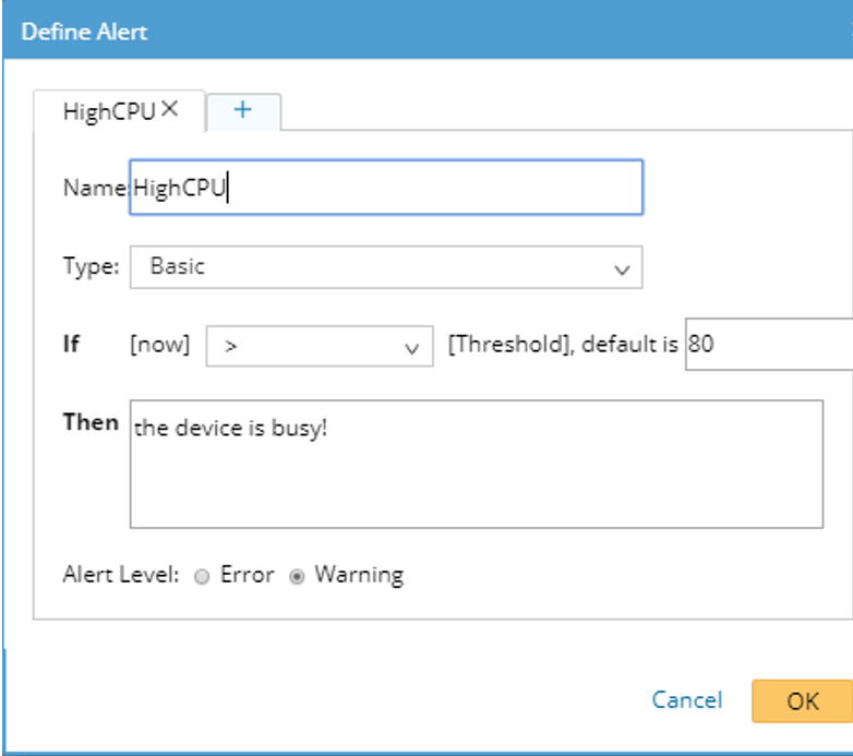

  5. Click the icon to define an alert condition for the five_sec_cpu_usage variable.
    1. Enter a meaningful name for the alert, such as HighCPU.
    2. Select Basic from the Type drop-down menu.
    3. Select >= from the drop-down list and enter a value in the threshold field. [now] means the value of the current poll cycle, >= means larger than or equal, and [Threshold] means the limit value to trigger the alert.
    4. Enter a message in the Then field. For example, the device is busy!.
  6. Select an alert level. The color of a device varies from alert levels. If the Alert Level is Error, a device turns red; If Warning, a device turns yellow when the predefined threshold is reached.

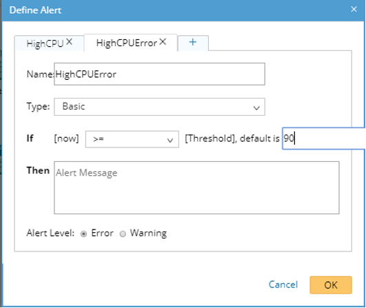

    Information TipYou can define multiple alerts for a variable. For example, define an error alert when the CPU usage exceeds 90.
