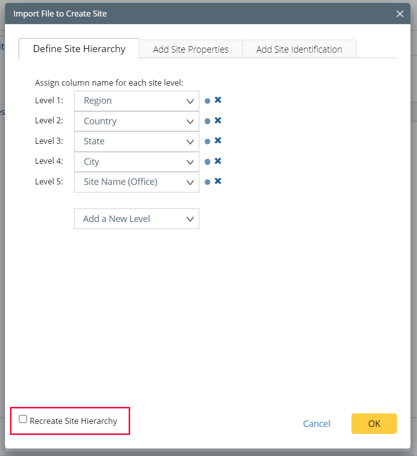

  4. Select corresponding levels to define Site Hierarchy. Level 1 is the highest level of a Site.

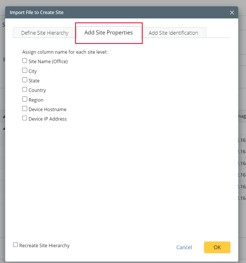

  5. You can also add specific columns as Site properties.
    Information Tip: The columns you checked will show up in the Site Properties window

  7. If you want to overwrite the current My Network hierarchy, you can check Recreate Site Hierarchy. This option will recreate My Network using the new hierarchy you defined in Define Site Hierarchy.
    Graphical user interface, table  Description automatically generated
