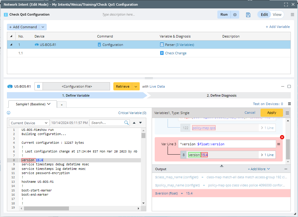

  1. Define Variables in NI edit mode.

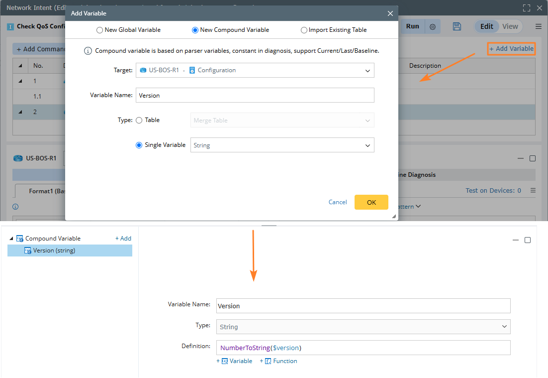

  2. Navigate to Add Variable > New Compound Variable. Select Single Variable and choose a variable type. Click OK.
  1. Define the Variable Name, Type, and Definition for the compound variable.
  • Name — A name can only contain letters, numbers, and underlines, and can only start with a letter or underline.
  • Type — The selection of the Type should be set according to the data type returned by the compound variable or formula.
  • Definition — The Definition input supports two ways: a mathematical operation, such as $var1 + $var2; Call the built-in functions. See Appendix: Supported Built-in Functions in Network Intent for a list of supported functions in NI.

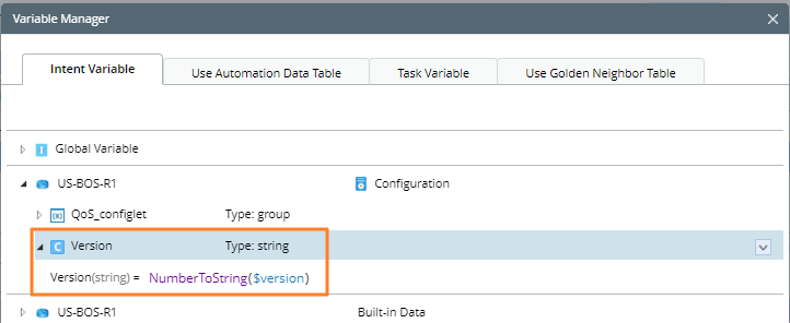

  1. Click OK, and the compound variable is added as a new variable.
