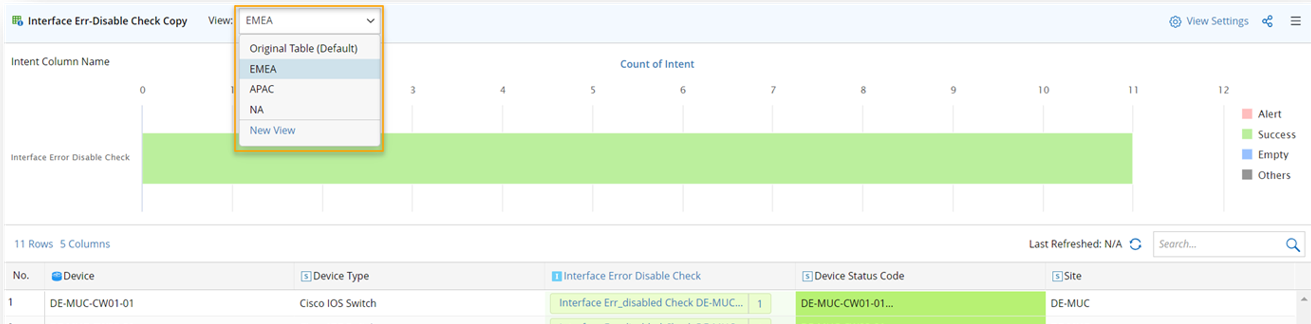

  • Several views can be created for an ADT. The original ADT (Original Table) and associated views are displayed in the View list in ADT Manager.

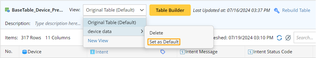

  • One of the views (including the original table) can be set as default. The default one will be marked by ‘Default’ in the View list.
