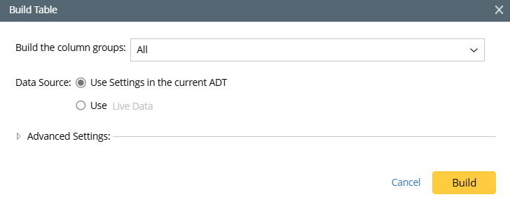

  1. Filter Row: Select sites or device group for filtering the data in the table row.
  2. Click Save and Build to save all the settings and build table data. You can define the build settings.
