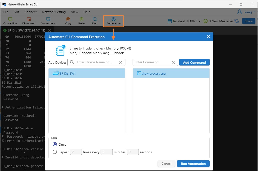

- Click Automate in the Smart CLI.
- In the Automate Command Execution dialog, complete the following steps to automate the command execution.

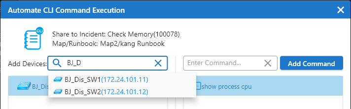

- Select devices. Enter a device name or IP address and then select the matched device from the populated drop-down list. You can also directly select incident devices if an incident is associated.
- Add commands for selected devices.

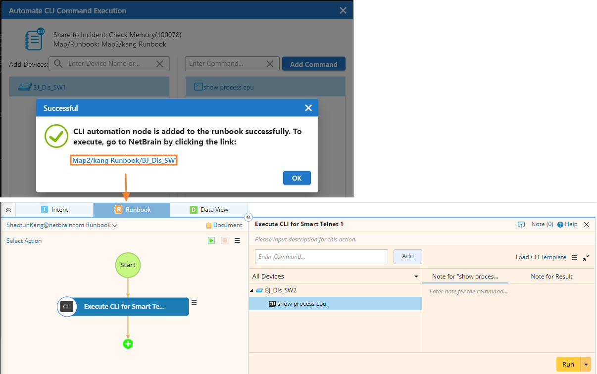

- Click Run Automation. In the Successful dialog, click the created map/runbook link to switch to the NetworkBrain System for your further operations. The defined device and command will be added to the Execute CLI node of a runbook.

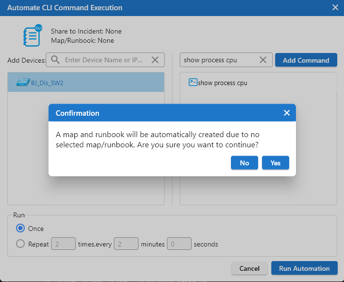

Note: If no map/runbook is selected, you should click Yes to create one first.
