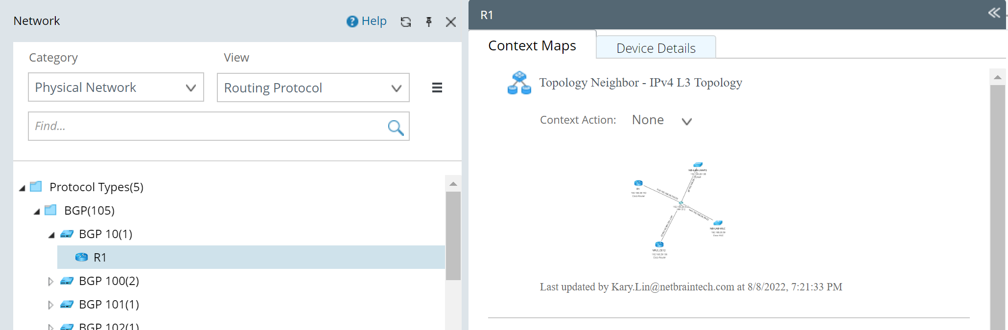

To view the details and the context maps of a node, proceed with the following steps:

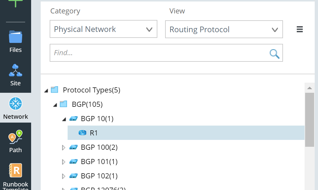

- Select Network in the left pane of your NetBrain desktop.
- In the Network pane, select Physical Network in the Category field.
- In the View field, select Routing Protocol.
- Expand the BGP node to view more information.
Tip: The number next to each node indicates the number of its child nodes.
- Select a node and the Context Maps tab to view its context maps. You can click Open Map to view the context map.
Tip: The context maps display the L3 Topology or L2 Topology.
- Click the Device Details pane to view the node’s detailed property, interface, and IP interfaces.
