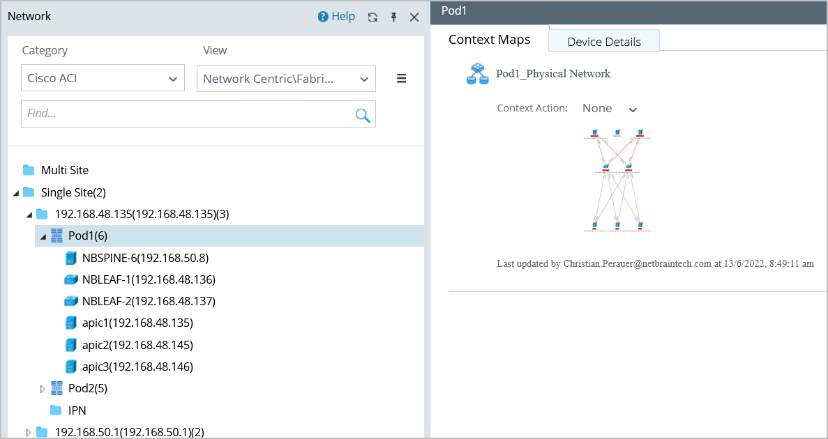

To view the details and the context maps of a node, proceed with the following steps:
  2. In the Network pane, select Cisco ACI in the Category field.
  3. In the View field, select Network Centric > Fabric POD View. The network-centric view allows you to see what nodes are part of the ACI fabric and how they connect to the rest of the network.
  1. Expand the Single-Site node to view MSO (Multi-Site Orchestrator) information.
Information Tip: The number next to each node indicates the number of its child nodes.
  1. Select a Pod node and the Context Maps tab to view its context maps. The context map displays the physical topology of the selected Pod. You can click Open Map to view the context map.
Information Tip: For more context maps supported under the Fabric POD View, see Context Maps for details.
