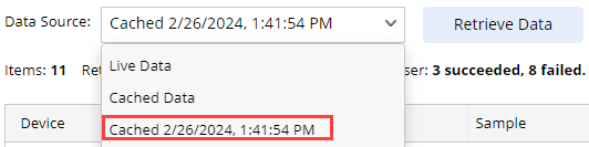

  • Cached Data(from live retrieval): The retrieved data stored in the database. Each previous data retrieval will be stored and accessible in the drop-down list.
    Information Note: This is a dynamic data source and not available for the first-time retrieval.
  1. Click Retrieve Data.
  2. Check the Sample column to determine whether the sample data is retrieved successfully.

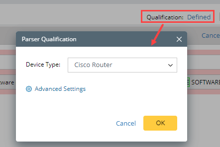

    Unqualified The device does not belong to the selected device type in the Qualification.

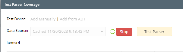

    Empty Cell The process was stopped before the data retrieval started for this device.
