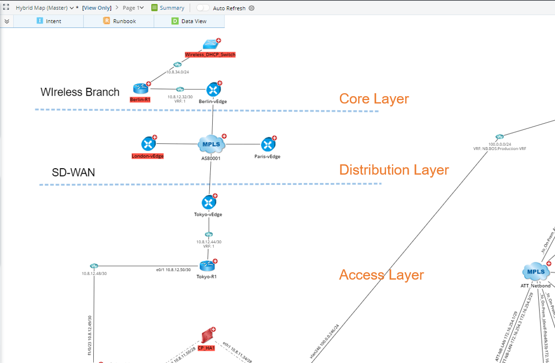

Example: A layout of a three-layer hierarchical network.
A layout by tag is generated by applying a layout style to a map. A layout style defines the method to organize devices on a map. It consists of layout type, layers, and tags.
Graphical user interface, application, tableDescription automatically generated
  • Layout Style — defines the overall outline of the map layout.
  • Layout Layer — divides a layout into different layers to reflect network hierarchical layers, such as the core layer.
  • Layout Tag — used to mark devices and layout layers to identify which layout layer a device belongs to.

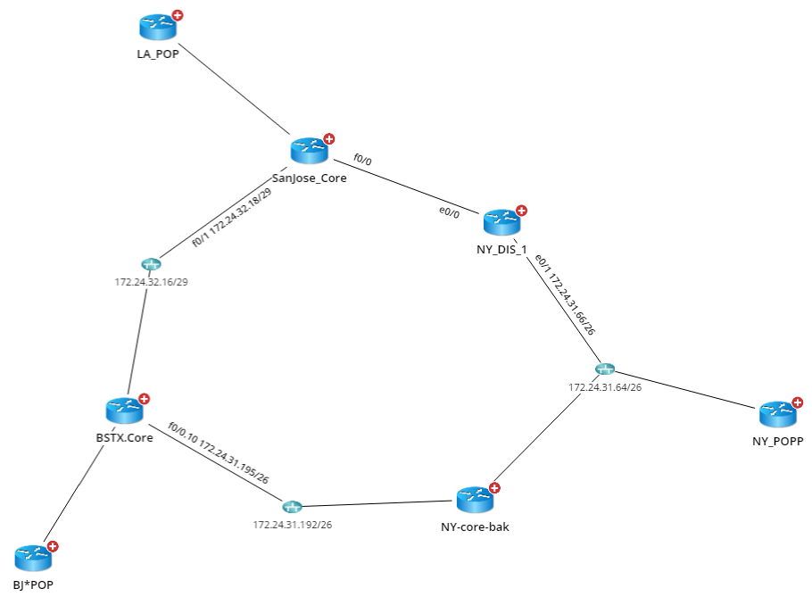

Symmetric LayoutGraphical user interface

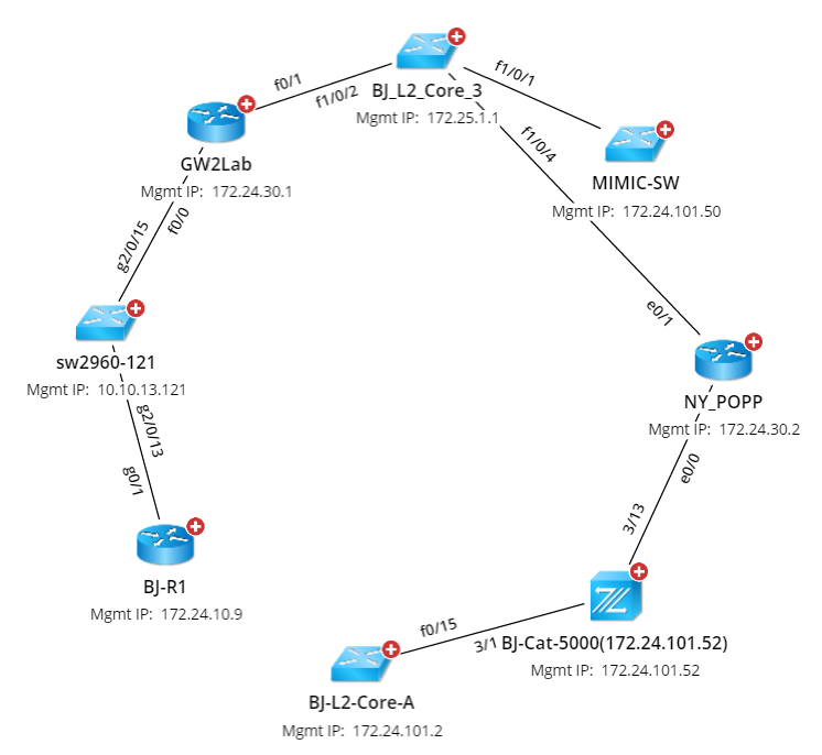

Circular Layout

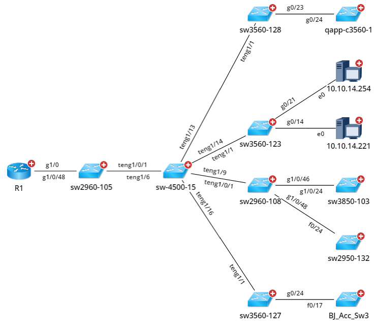

Orthogonal LayoutDiagram

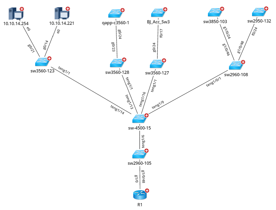

Upward Tree Layout

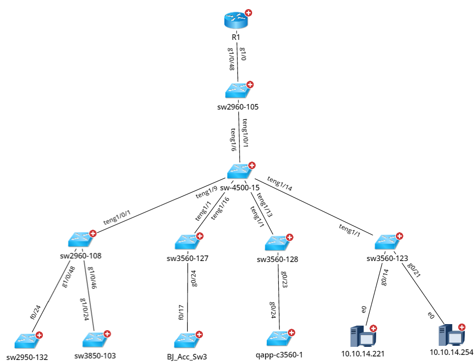

Downward Tree LayoutDiagram
