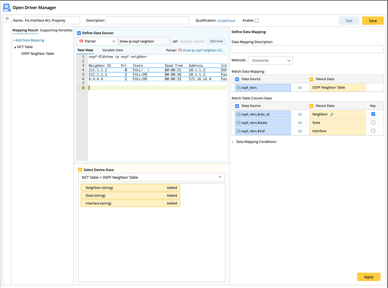

Follow the steps to create a new NCT table via Open Driver:

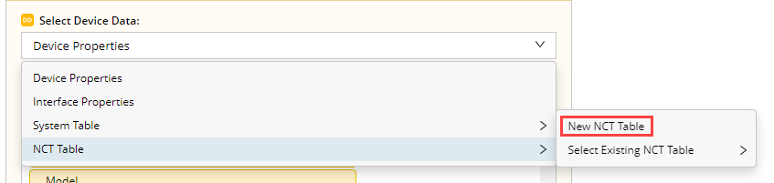

  1. On the Open Driver Manager page, select NCT Table> New NCT Table.

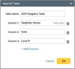

  2. In the New NCT Table window, define the table name and column names, and set one column as the table key.
  3. Enter a CLI Command and define its Parser to fill the NCT Table.
