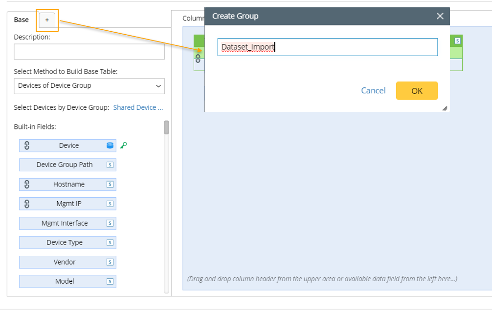

  1. Go to the Automation Data Table Builder, create a Base table, then create a new group and name it (for example, Dataset_Import).

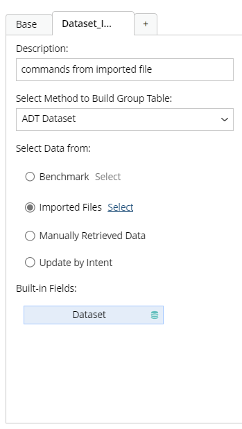

  2. In the left pane of the new group tab, define the following settings:
    • Description: Type descriptions for the column group to describe its use and function, e.g., "commands from imported file".
    • Select Method to Build Group Table: Select ADT Dataset.

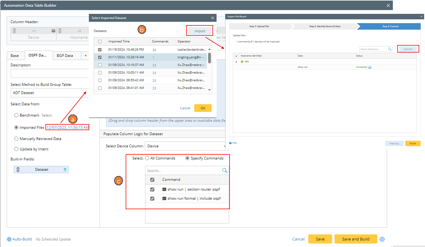

    • Select Data from: Select Imported Files.

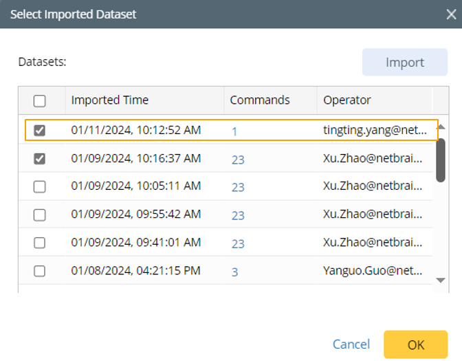

  3. Click Select adjacent to the Imported Files optionthe Select Imported Dataset window will display, then you can select an imported dataset (e.g., the dataset 01/09/2024, 10:16:37 AM).

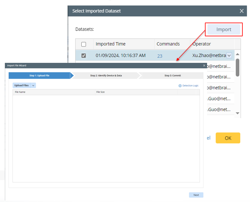

    Alternatively, if you need to use a device command data file that is not in your domain right now, you can Import the file via the Import File Wizard. Click the Import button in the Select Imported Dataset window to start the steps of importing file via wizard. For the steps in Import File Wizard, see Define Import File Wizard.
    Information Note: The Import File Wizard that opens from the Table Builder does not support updating device model when importing commands. In addition, only the first three steps in the Import File Wizard are available.
    After successfully importing the file, the imported dataset will be added to the dataset list.
    Click OK to close the Select Imported Dataset window.

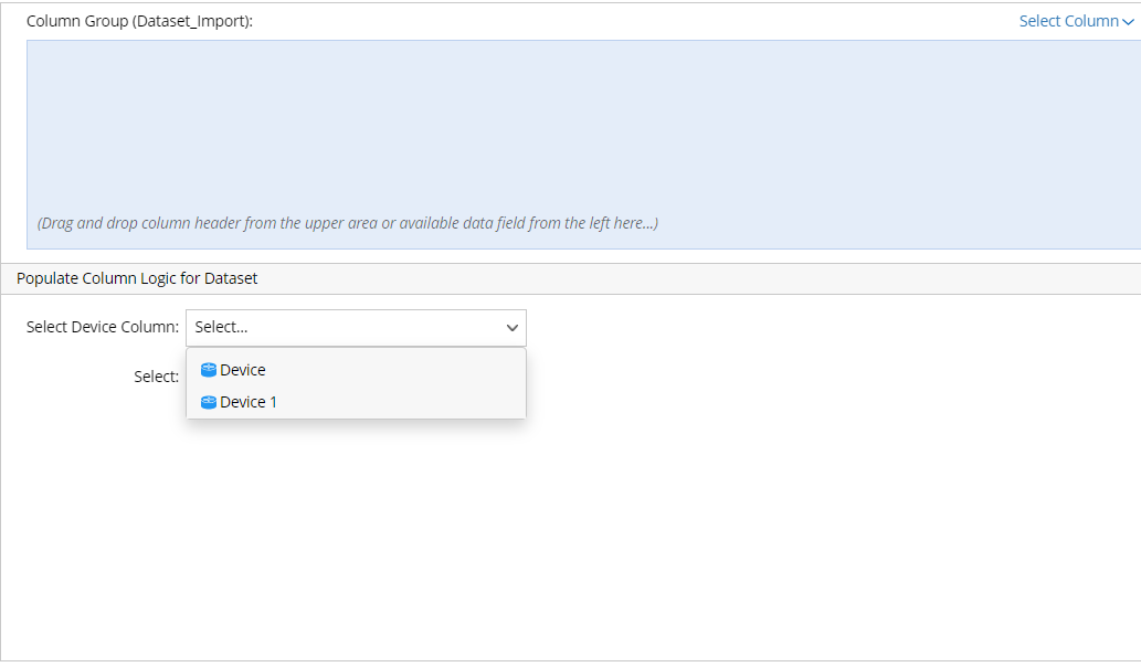

  1. In the right pane, select Device from the Select Device Column block. The selected device column in the ADT will be the device column of this dataset. Only the command data of the devices in the selected column will be added to the dataset column.

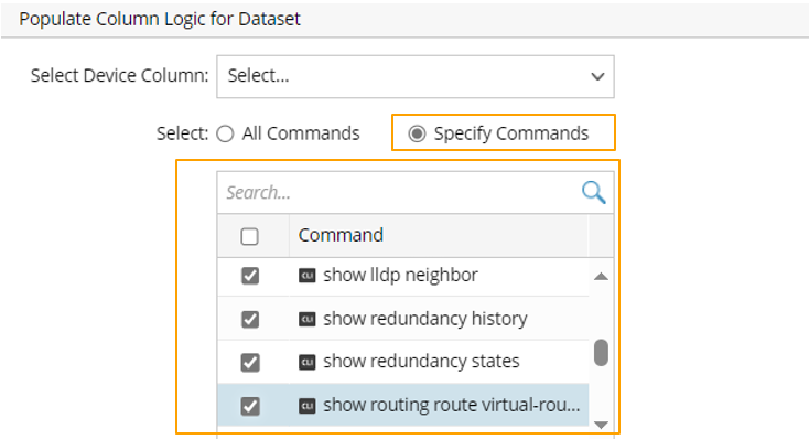

    Select commands: Select All Commands or Specify Commands to determine which commands will be finally added to the ADT dataset.
    All Commands (default): All commands from the imported file will be added to dataset.
    Specify Commands: You can check the checkbox to select commands from the imported file. In the current example, select Specify Commands, then select several commands from the pull-down list.

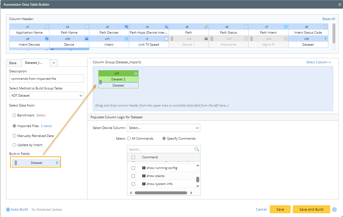

  2. (Optional) Click Import from the Select Imported Dataset dialog, then repeat the steps (in step 3) to add more datasets via the Import File Wizard. If several datasets are selected, the number of datasets will be displayed next to the Imported Files option.
  3. Mapping available fields to Column Group: Drag and drop the available fields to the column group definition. When Dataset column is built via the Dataset method, the built-in field is Dataset.

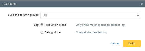

  4. Click Save and Build, the Build Table dialog will display.
  5. In the Build Table dialog, select columns groups to be built and select a log mode. Click Build
