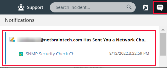

If a task creator requests to approve a Network Change task in the system, the designated approver will receive an email, and system notification after the approval request is submitted.
Example: Approve an SNMP Security Check Change Request.
  1. Click the SNMP Security Check Change hyperlink in the notification list.

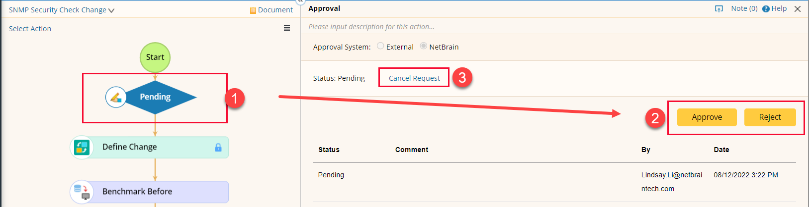

  2. In the Runbook pane, click the Pending node.
  3. In the Approval pane, click Approve.
  4. Information Tip: you can also Reject the request or Cancel the request.

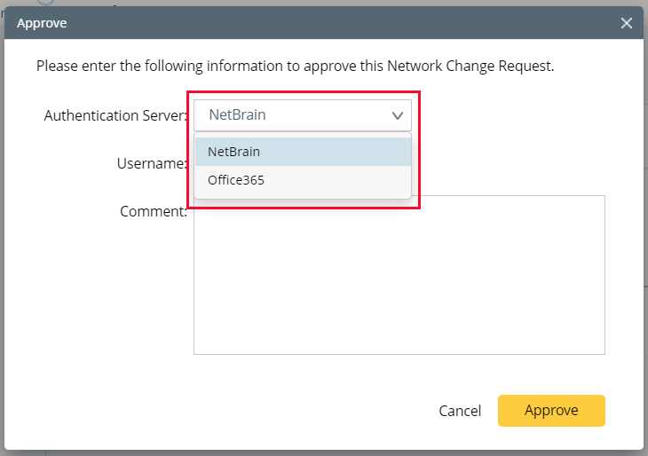

  5. In the pop-up dialog, select Authentication Server and enter the required information of the approver account, and click Approve.
  6. Click Yes to confirm the approval in the Confirmation dialog.
